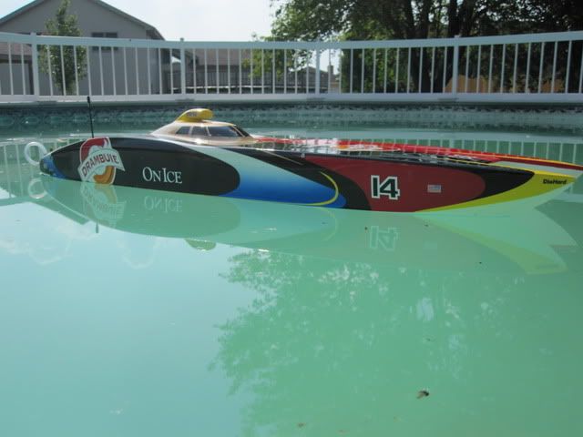

    She floats!! I actually did a few laps around the pool real quick too.
