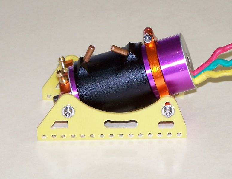

                  looking back over the pic you posted below, you wont be able to get much of anything over the motor................since you can only cool about half the can, a coil will not be a good idea.................go with the short jacket then............you need as much cool water in direct contact with the can as you can get............I just remembered you are not running a Feigao, the HK's run hotter. Here is a pic of your cooling area - not much:
                    if i use a coil i can still make one for the rear, and middle... i just thought that it would be better having direct contact with water useing the other jacket then a coil but eather dont matter not going to be running it too hard when it get out there but i will have my fun
