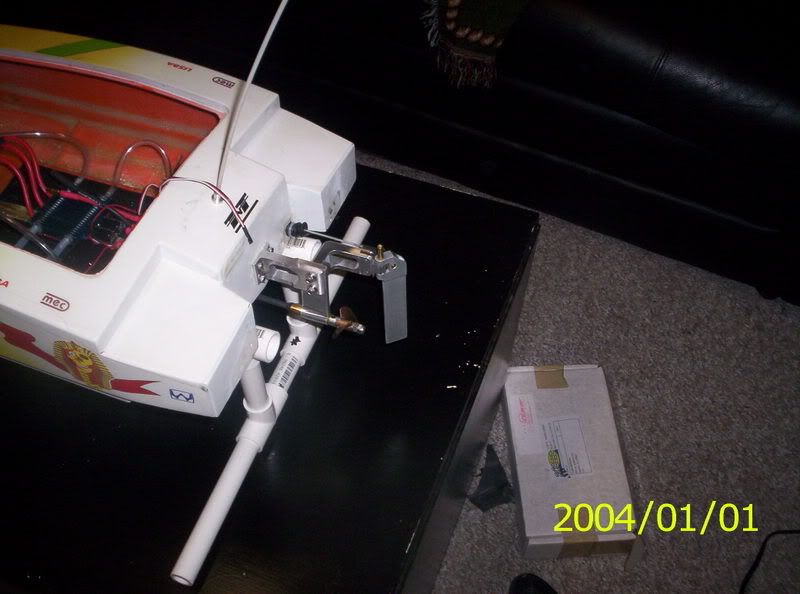

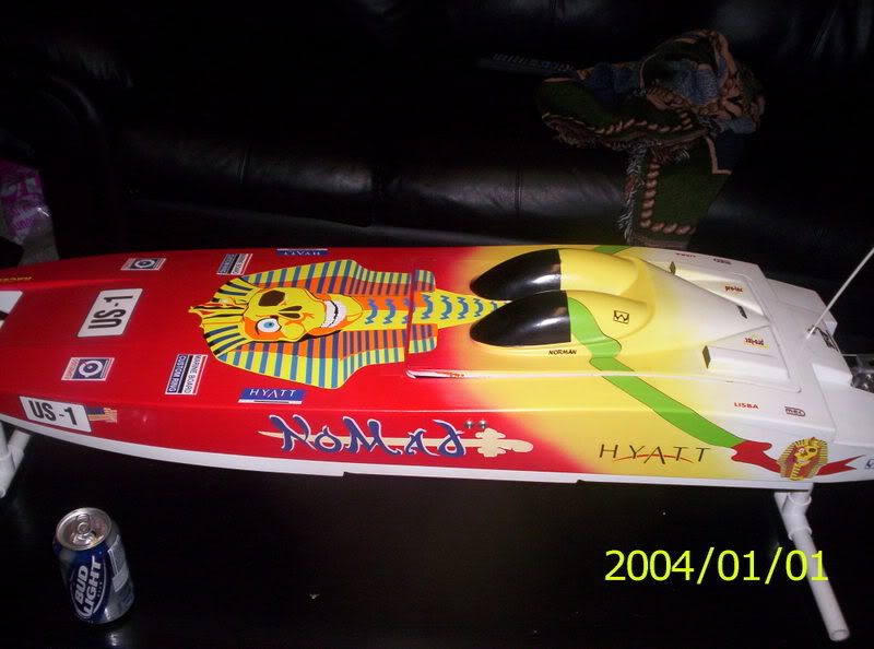

    well my nomad is almost done. i just a a few little things and hope to get it in the water this weekend. im going to be running a mega 22/45/2 geared on 22 cells with a x447 or x646/3 prop. with 22 cells it give me about 36000 rpms at the motor. im starting out at 2:1 ratio which should give me about 30mph with the x646/3. here a some pics.

      the oemrc its 100amp 36v. i was going to use a castle hv but castle told me it would almost be impossible to water proof it. as for the vid i cant get my camera to upload any video but im sure its because im not doing somthing right.

        oic.........is that esc waterproof.......... i think it was you that told me it has been a good performer with people in your club..........not sure though...........how are you watercooling it

          i sprayed it with corrision x and to watercool it i just drilled 2 holes and slid the 2 tubes in the holes and secured them with jb weld.

            cool! I like the egyptian skull thingy! how big is this boat? what brand? cant wait to see it on video!

              its a mhz nomad xl 42.7"

                what size drill bit did you use on the speed control

                  42" ??? electric ???? You are a brave man !!! I was going to be sarcastic but how's things have been lately on here I'll just be direct....was a beautiful paint job !!!!

                    hammer i used a 5/32 bit and tubing. i did not paint or decal the boat. it was a used hull. i would not have this if i did not find this used one. a new hull and decals cost about $450.
