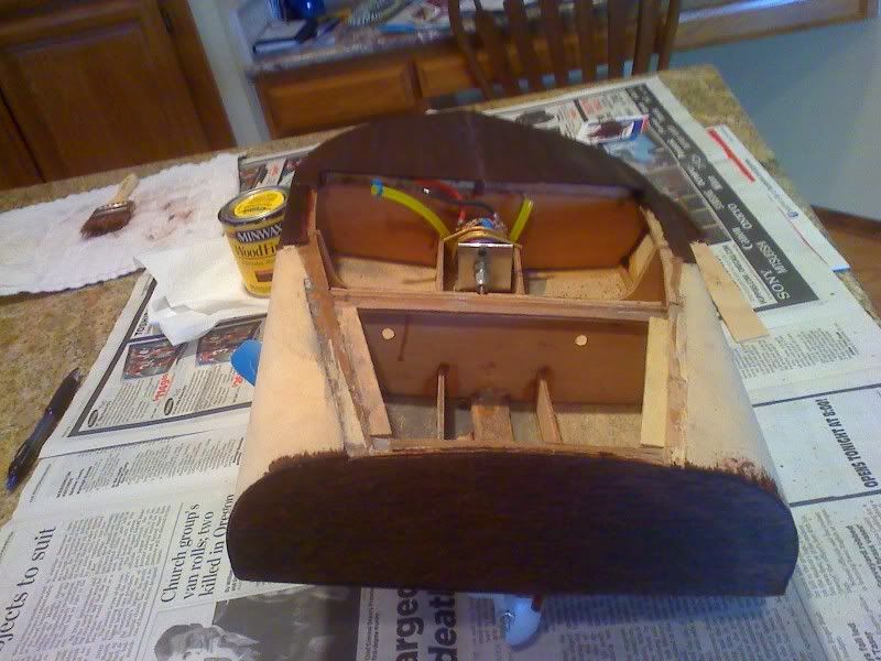

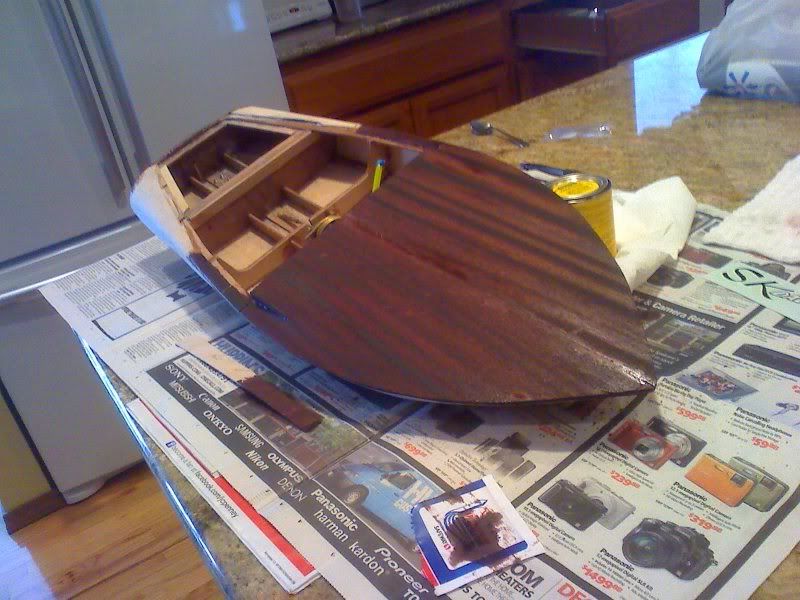

                here are some new pix, started to stain the boat. Just need to fiberglass the inside, paint the sides, install all the running gear and i can go test it. :yippee:
                edit: just fiberglassed the inside, at this rate i might get to test it out sunday
