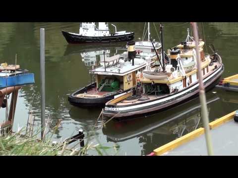

        Thanks for the video!!!! That was really NEAT!!!!
