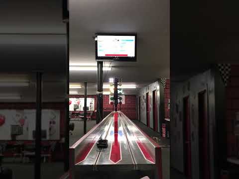

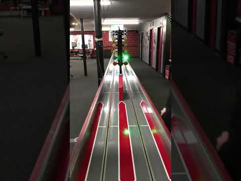

                        Thx. It’s actually a little bit of work to do this so maybe the average joe may not be able to duplicate it. I used a micro mamba motor, a airplane 6s esc with a pistix and then a micro spektrum receiver. I took everything apart, shortened sero wires and epoxy coated the boards to do away with receiver case. If I didn’t mention, there’s no battery, I run off of the track power. It worked flawless last night and there was a crowd watching.

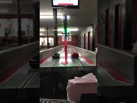

                        Next up is more gear and wider tires. I just ordered the tires and picked up some bigger spur gears last night. It leaves a tad bit lazy right now because I have the punch dialed down because it’s just too violent. The 60ft is horrible but a few feet out it turns on. I’m thinking with more gear, more tire and a tad more punch it’ll do much better. The 60ft was slower than most slow cars and the et and mph was up there with some really quick cars. Here’s a video with it dialed way back vs my gto. Look at the 60ft how poor it was but it turned almost the same et and mph as the other car leaving way harder. That just tells me how much power the brushless has.

                            GTO got treed.
                            Larry
                              Originally posted by TRUCKPULL
                              GTO got treed.
                              Larry
                              Yea. I had the camaro turned way down because it would beat the gto badly. I was trying to be fair and the times and mph were very close. The Beauty of brushless....the tuneability.
