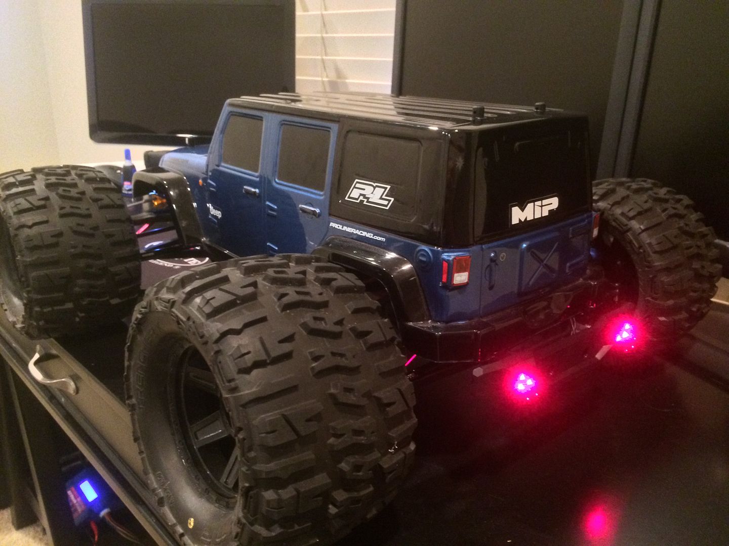

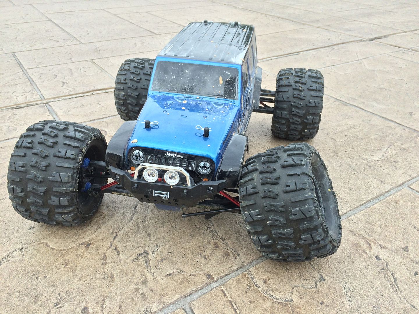

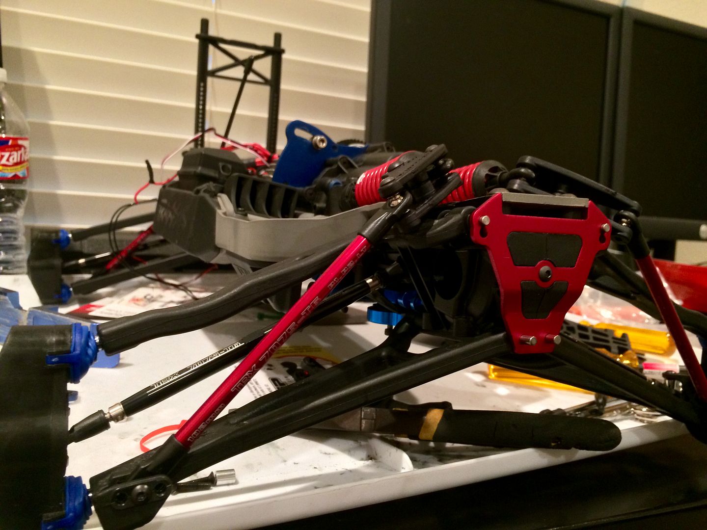

    I started this build in January and pestered the heck out of "thejc" for 5 months about Losi drivetrain conversion. I tried to get RCM diffs so I didn't have to do the conversion but that wasn't happening...
    So I will start with the Losi diff list first:
    15x21x4 (TWO PER AXLE, 8 TOTAL)
    8x13x4 (THREE PER AXLE, 12 TOTAL)
    MBX-1215 Mugen 17mm Hexes
    Losi LOSB3516 17mm Hexes
    Losi XXL 2 Front Differential
    Losi XXL 2 Rear Differential

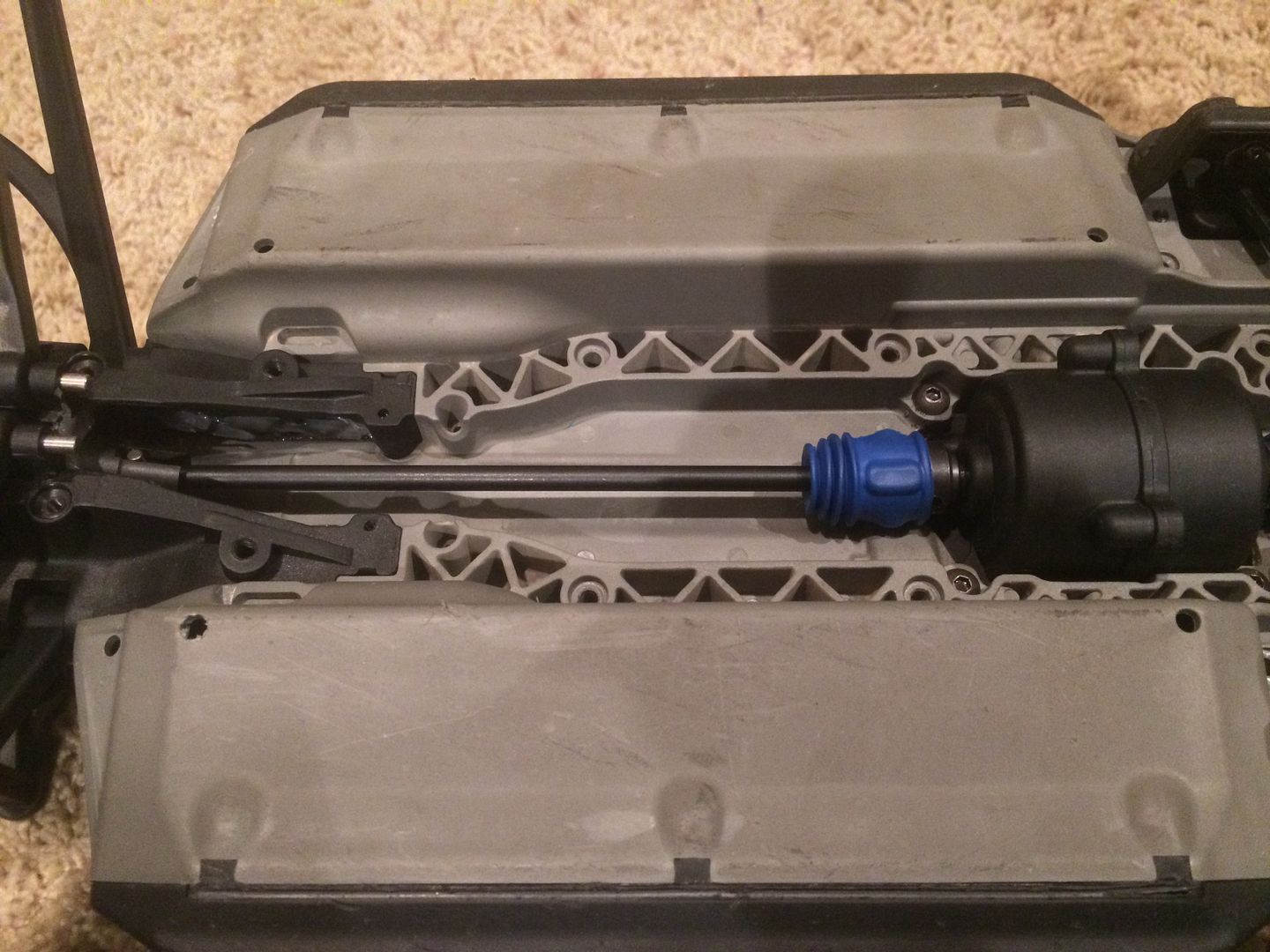

    Losi XXL 2 Front & Rear Drive Shaft CVDs
    Kershaw Designs E-Revo Center Dog Bone Kit for LST Diffs
    SOME SHIMS WERE NEEDED AS WELL! Not sure what size since I had them done for me... haha
    Some have said that they have had bad experience with Kershaw designs but that was not the case for me! He shipped my dogbone kit the next day and everything showed up perfectly! I read into a lot of threads on the forums and most of the "claims" were fixed by Dan at KD or the claim was BS. Dan Kershaw is not around to screw people out of money, he is around to help the RC community. If you are in Colorado he is opening a store so you can come in and buy parts off the shelf which is pretty cool.
    Here are my other parts as well:
    80wt shock fluid/oil in stock shocks
    Traxxas Summit arms
    VG Racing black springs (not installed yet)

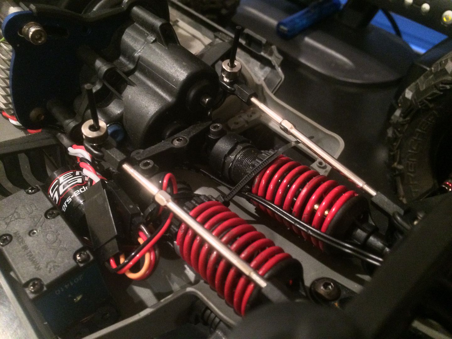

    TRX: 5323R (Red tie bars instead of the TRX blue...)
    TRX: 5318X (Red aluminum pushrods)
    TRX: 5338A (Black aluminum toe links)
    TRX: 5632 (TRX Chassis brace)<<SHOULD BE AVAILABLE IN RED!!!!
    TRX: 5498 (Sway bars, I have only installed the front)
    TRX: 5133 (Red Pushrod Spacers, not sue if Needed them...)

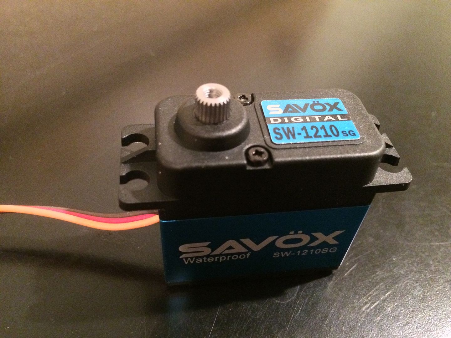

    Savox SW-1210SG Waterproof Coreless Servo,turns 3.8 Trenchers on carpet!
    HR: RVO4806 (Natural aluminum wasn't in stock)
    Unknown Aluminum front and rear skids (came with used roller)

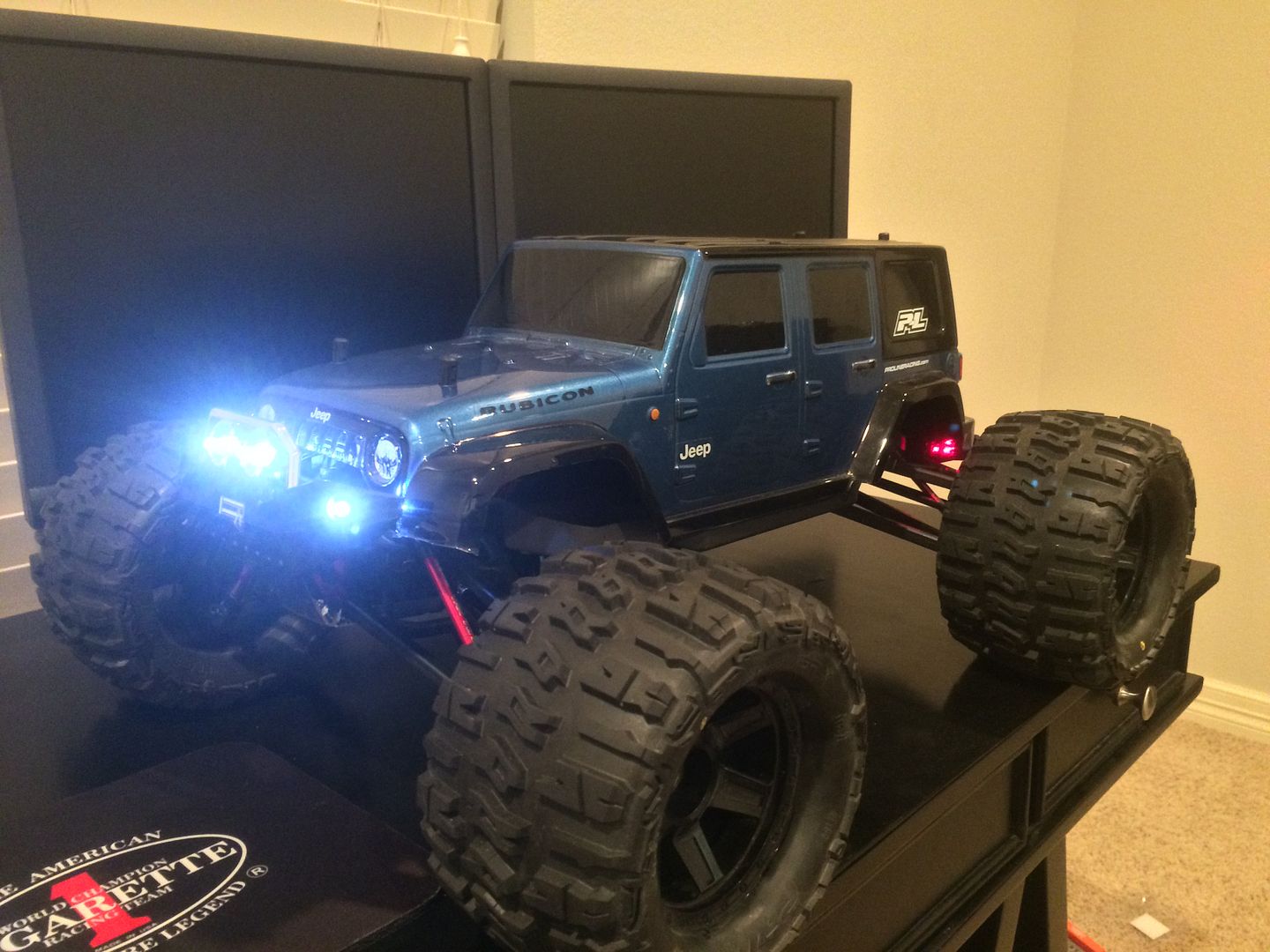

    PL: 3405-00 (Awesome Jeep Rubicon body, painted by previous owner)
    Dragon Slayer Heatsink for stock motor.
    Stock MXL-6s (TRX Re-branded MM2)
    Full TRX telemetry (not calibrated due to different Losi diff ratio)
    HbbyKing: Dr. Mad Thrust Electronic On/Off Switch (for my leds in the Summit bumpers)
    SPC 2s 6500mah (Two)
    SPC 3s 6500mah (Two)
    BIG SHOUT-OUT TO "Thejc" and "rc-fan" for helping with the Losi conversion!!!!!

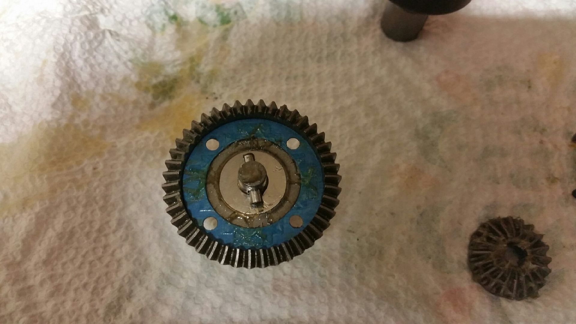

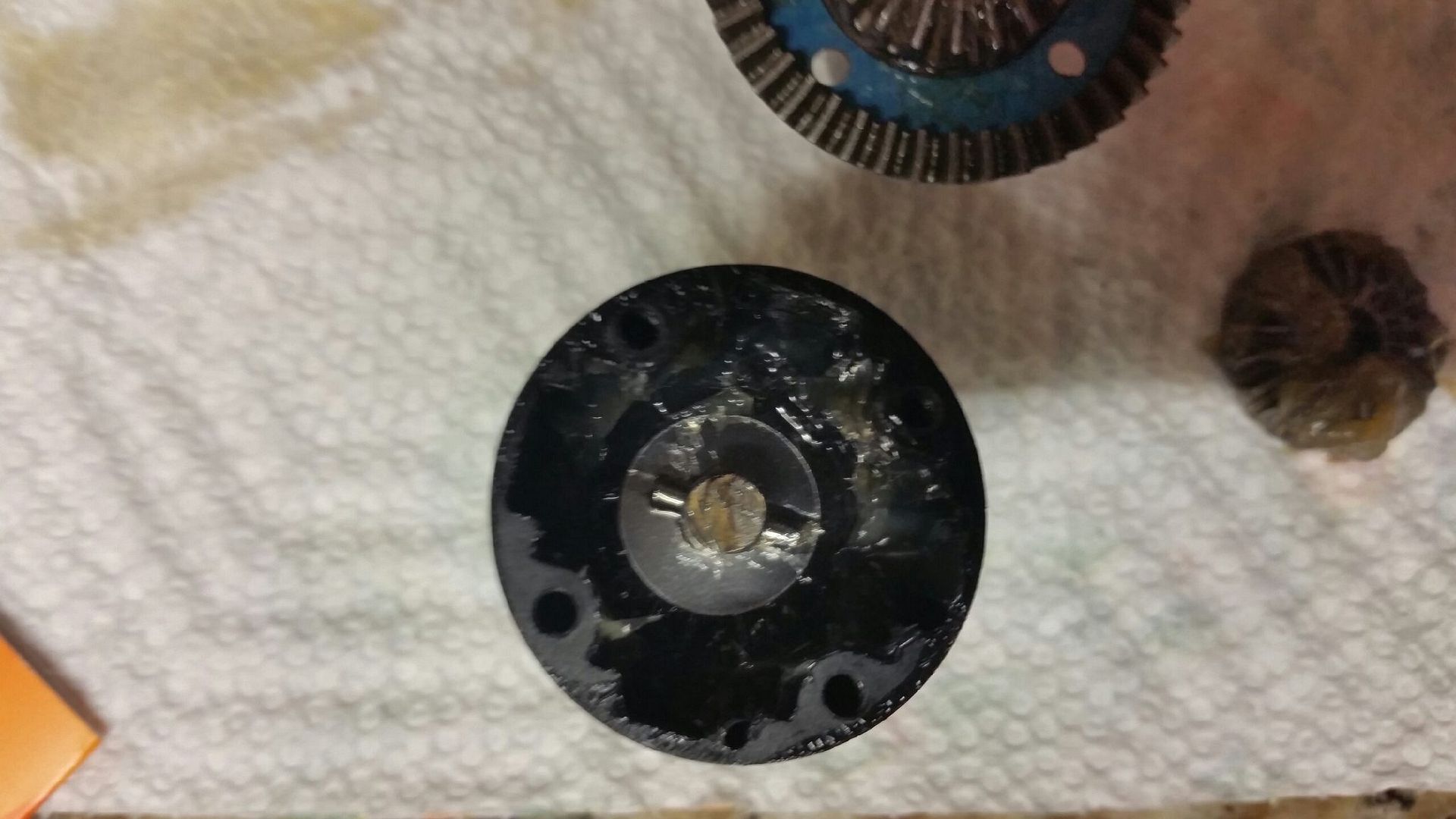

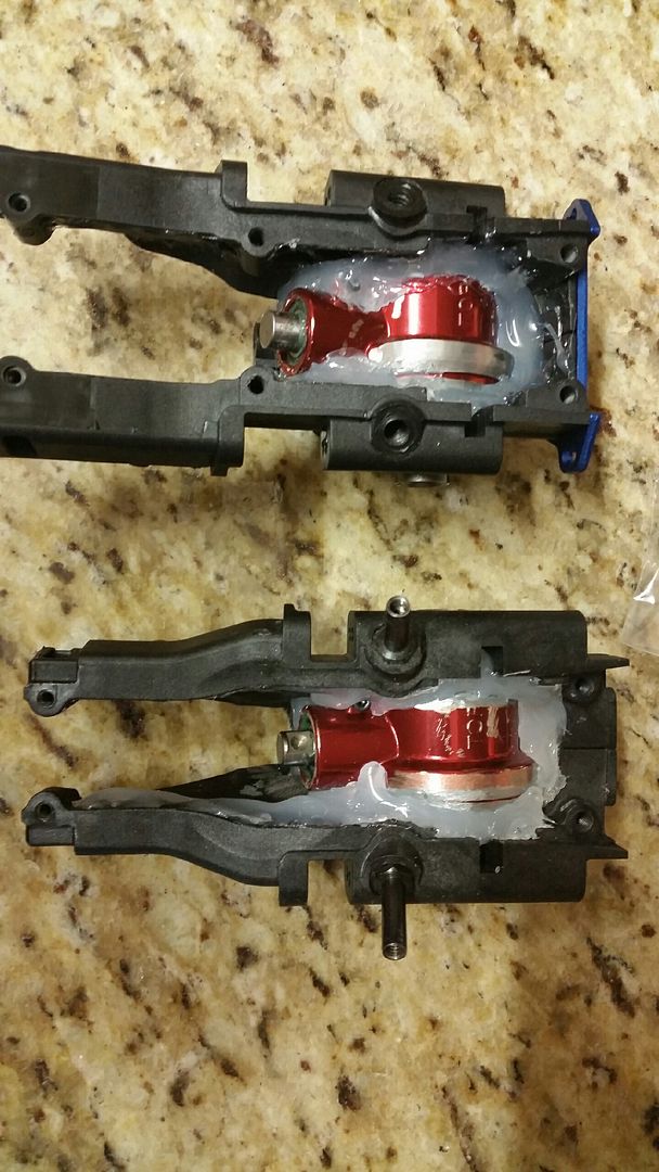

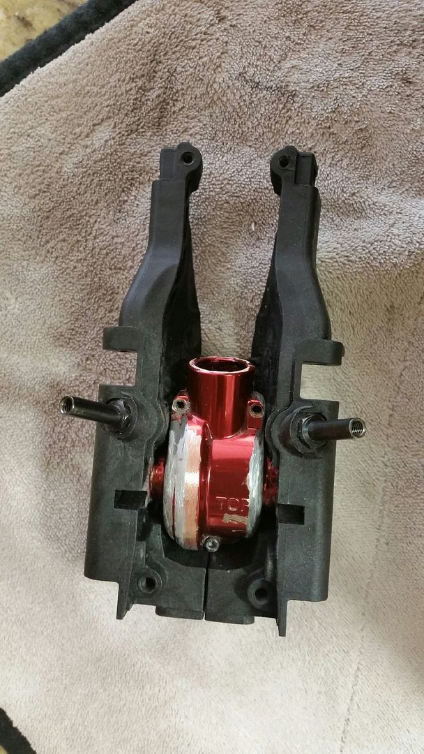

          Losi Diffs Conversion pics:

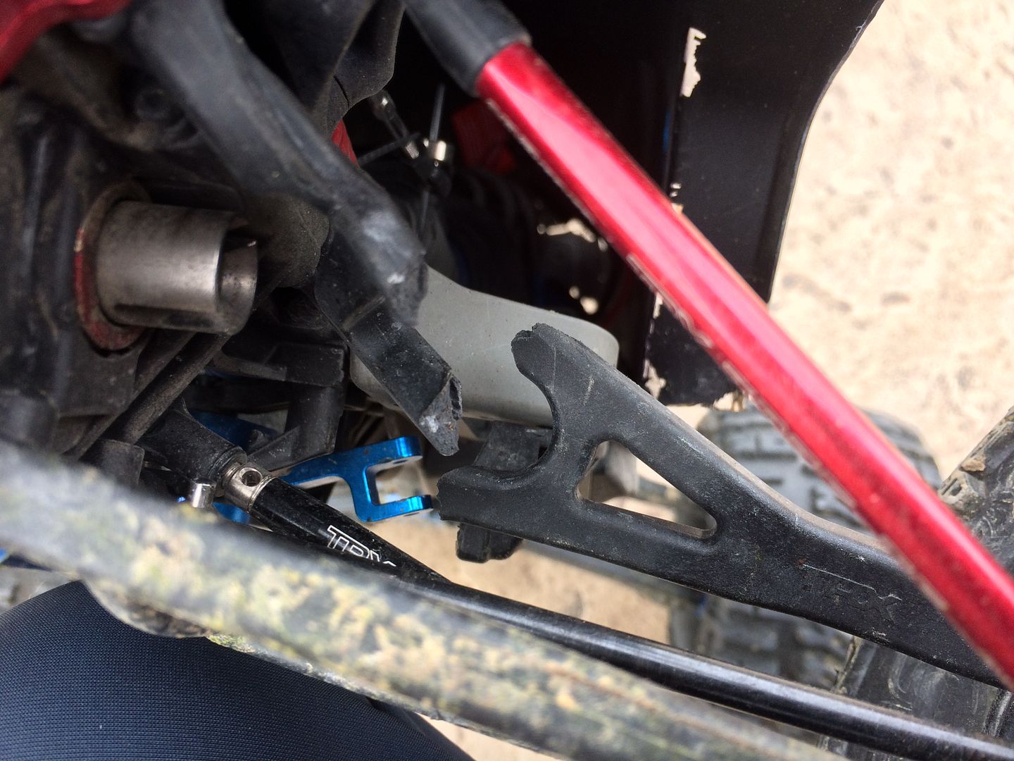

                Thanks! I just ordered some new Summit arms since I had an accident.... lol I run 5s so it shouldn't be too stress full on the diffs. I had them ground down by my guy Carlos in Florida, he was the previous owner of the roller and had the losi diffs in before he parted it out.

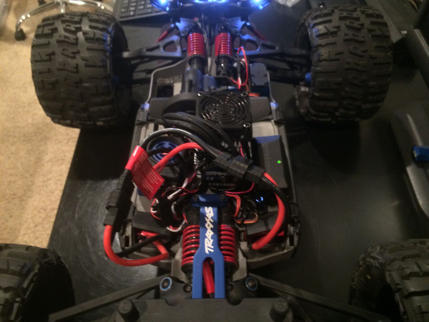

                        • 8750

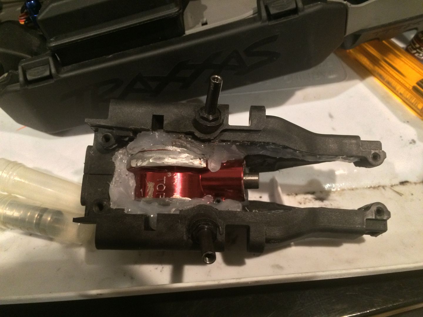

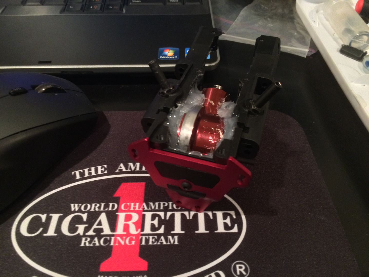

                        Is that hot glue holding the diffs in?
                        • Spartanator
                          • 1060
                          Originally posted by srislash
                          I had a Rottweiler run off with my Monster Beetle once(yup, long ago).
                          Hehe, did you get it back?
                          It just is additional "bracing".... But short answer, yep hot glue. Better than having empty space.
