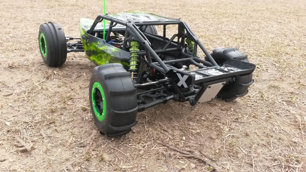

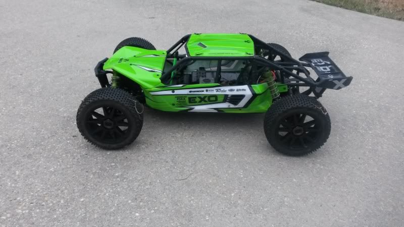

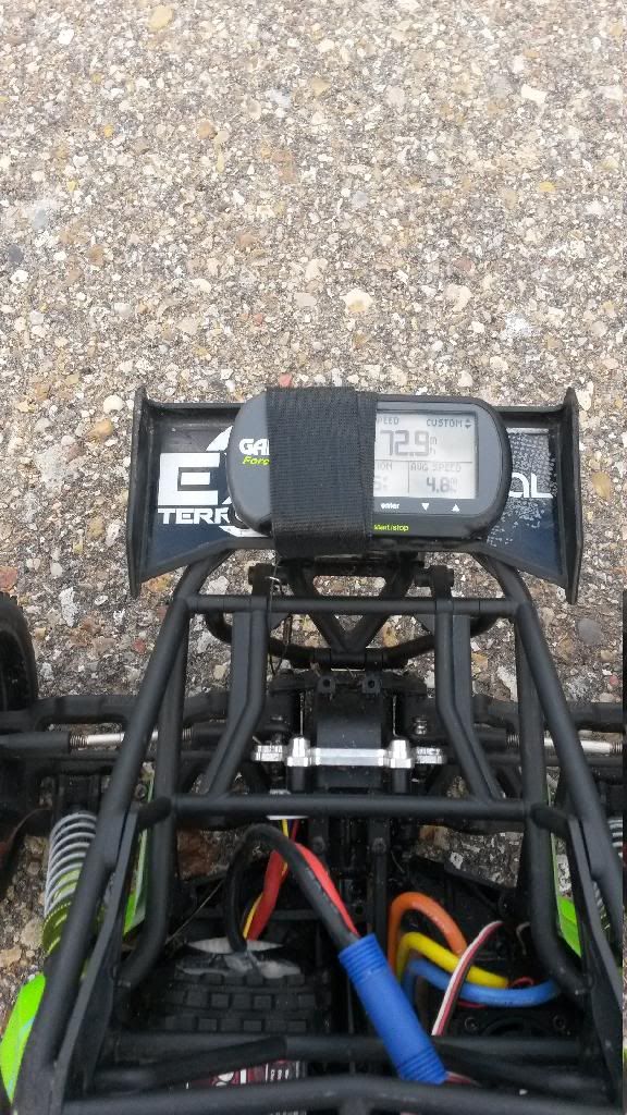

    Well its been cold lately and I decided im not going for a swim should I flip my boat and for some reason my recovery doesnt do the job. I kinds been slacking on it anyway but after last weekend its almost done. Just waiting on a couple more parts. Anyway, I have to have something to keep me occupied and I have a couple rc buggies. I've gotten on this kick of trying to see how fast I can make something go that totally wasn't designed to do it. I picked probably the worst vehicle for going fast but it looks the coolest by far. Its an axial exo terra buggy. I sank more money than I care to think about in this thing. Ridiculous. I took it out today and did some speed runs with it. Beat my goal too. I was shooting for 70mph. Heres some pics.
    Sand mode!
    Street mode
    And how fast it went today on 3s lipo with a 4000kv 550 reedy motor

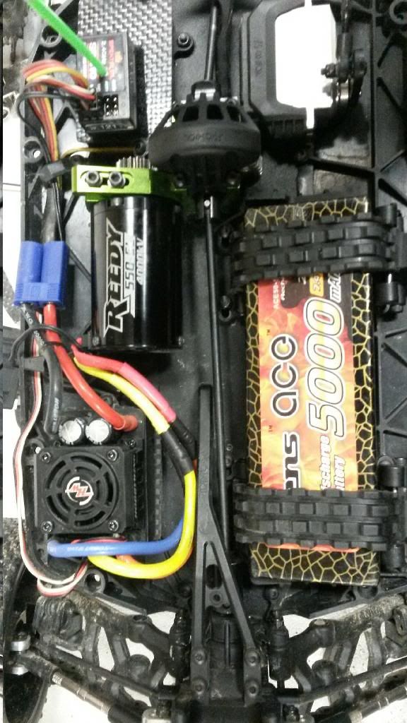

          Well I never had any axles break. Im still using dog bones. The cv shafts do break and I learned this beforehand so I never bought them. I have stripped the diff gear, spur gear and spider gears tho. Everything has been upgraded to hardened steel parts and some billet suspension pieces where needed. Heres the 72.9mph run

                  Actually that stretch of road is short. I have to be careful because sometimes I cant stop it before the curve and it'll go flying. Lol. It is the rtr version. Almost everything has been upgraded or replaced besides the chassis and cage. I have a reedy 550 sl motor. They are about $55 new shipped. Seems to be an awesome little motor. I took it apart and put ceramic bearing in it and it looked pretty well built. Temps stay under 160 even when bashing with a 25t pinion. I heard the hobby wing motors were pretty stout but I ended up buying a 4600kv tenshock 411hd the other day. I haven't tried it out yet. Its a sensored motor and I was told they go pretty good. On a side note, on 2s I gps it at 53.9mph yesterday. Pretty stout on 2s. Lol

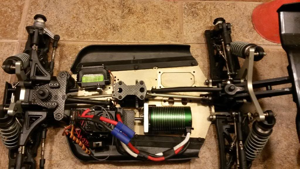

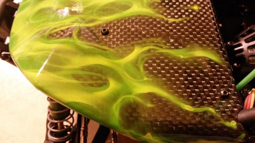

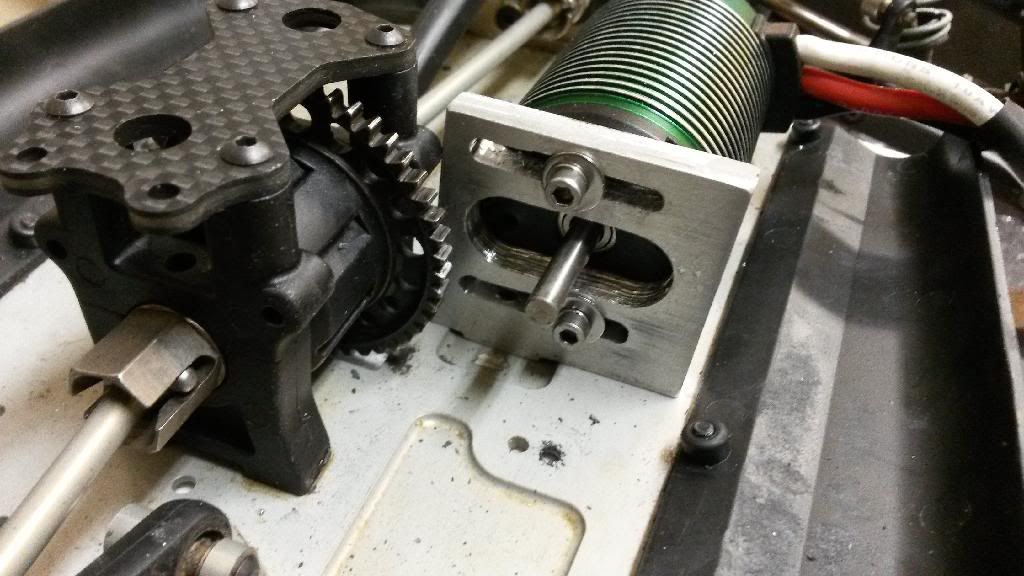

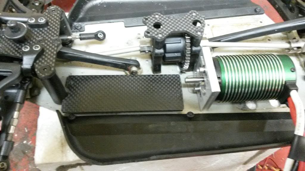

                          Heres something I did last weekend. I converted a nitro 1/8 buggy to electric. I made the motor mount, battery tray and electronics tray. Pretty easy actually. This thing flat out rips. It has so much torque on tap that the acceleration is instant. I have a 1512 2650kv motor in it with a mamba monster 2 esc. Sound familiar? I stole them out of one of my boats lol. Guess im gonna have to buy extras now because this buggy is too fun.
                          Mount I made. Notice I didn't want to be limited on pinion size lol
                          Heres the buggy getting some air
                          And its first runs up and down the street with a small pinion
                            And a speed run
