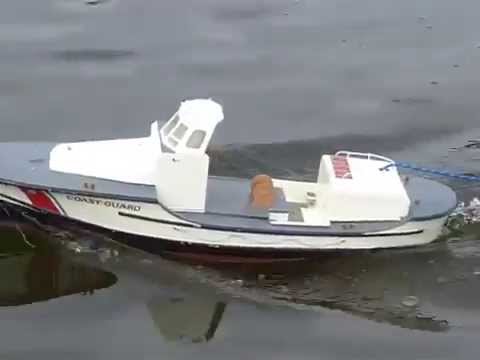

            Still running my tug in a box, it works great. This one is a Vac-U-tow. I've tried a few different setups, the smaller Vac-U-Tug and I used a Villain Ex for a few years but the tug boat props work a lot better at low speeds.
            I repowered a 44" Dumas Coast Guard boat for a buddy to use with a towed line and hook. Our pond can get a little weedy and I was a little worried about getting hung up in the weeds with that setup.
