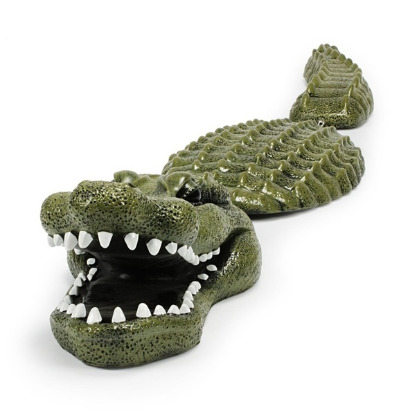

    Hello, I'm brand new to this forum, I have been looking for a couple of days and am excited to try some new stuff with R/C boats. I have an old Dumas hot shot 21 I built 20 yrs ago and have had a blast with it. The town I live in now won't allow gas boats on the lakes at all, so I'm looking into fast electric stuff.
    I need help with my first electric boat project. My son wants to make an alligator decoy into a R/C alligator. I'm trying to find out what and where to get the stuff to put into it. I have a bunch of R/C electric planes and was wondering if that stuff would work in a boat. Also where can I find props and shafts etc. I figure I need more power than speed for an electric alligator.

      Thanks, I've been looking at some of the stuff you guys have and WOW!!!!! I think I'm going to be hooked on more boats. Anyway I'm into R/C sailing and we need something to fetch disabled sailboats. I found this and thought it would be pretty funny.
      I think power over speed is, is what we want for this and maybe 15min run time.

        Long run times = high Mah capacity packs, Low Kv but high torque motors larger but lower pitch props for pushing under load.

          Thanks again, do you have any motor, ESC picks you like? I think reverse would be good too. I'm waiting to see what I really got, I thinks it's only 2lbs or so.

            If this is going to be a retrieval crocodile then a 580 12L on 4s 6000mah with a 450/3 prop and a Hydra 240 ( has reverse ) would be a good place to start, Low Kv, high torque and a thrust cone large enough to push anything

                The 180 amp marine esc at HobbyCity will do just fine and only about $100 with program box

                  I'm off the the pond for a few hours, one thought. the water cooling for the motor and esc, does that require speed to force the water in? The alligator will be very slow, maybe a car esc with a fan would be better??

                    have you considered a 'vac-u-tug' ( www.vac-u-boat.com )? methinks that having reverse with a 'boat' hinged in 2 or more places might be problematic...mayhap a motor/prop in the head and tail might solve some problems .

                      I have seen that before, I never thought about getting parts from them though. I'll have to see what I get in the box, maybe I could slap the head on top of the vacu-tug hull and be good?? This is kind of a crazy project to cob together.

                        Welcome to the forum. Have you considered a brushed 700 motor and ESC? On that croc', How were you planning on steering it? Maybe with a servo attached to the tail?
                        It would be a cool project if you could.

                          Not sure on steering, I hope just a rudder would work. I'll post pics when I get it this week. In the mean time I looking at all the boats you guys run. There a lot of awesome boats, I just found another hole in my wallet.

                            You can pick up a brushed 700 motor and ESC for less than $100.00 and probably use the tail as a rudder. Then use the money you save to start building an FE boat.

                              great, am I right that a water cooled system won't work with something that's going very slow?
