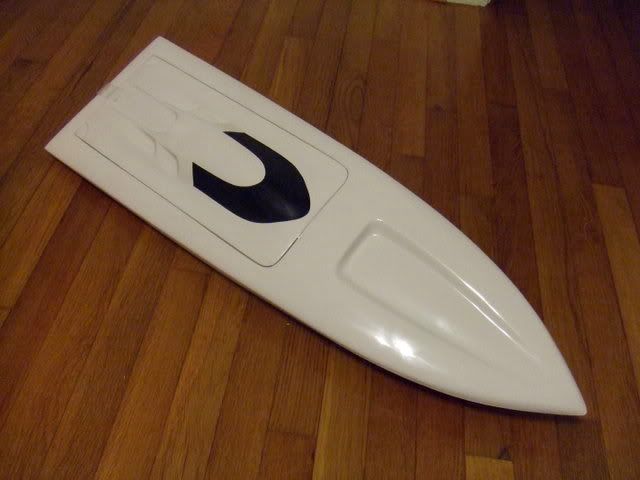

    Well the latest hull added to the armada is a white DF33.
    I have ordered a Hydra 240 http://www3.towerhobbies.com/cgi-bin...?&I=LXRJL6&P=7
    and a pair of Flight Power EVO25 5000mah 4s1p lipo http://www3.towerhobbies.com/cgi-bin...?&I=LXRWB0&P=7
    so far.
    I have also purchased a motor mount. http://cgi.ebay.com/FE-Boat-Brushles...3286.m14.l1318
    speedmaster stinger and rudder ordered from OSE. http://www.offshoreelectrics.com/pro...od=ros-monosys
    More to be announced as it unfolds, the due date for this project is 7-20-08
    I think this hull needs some red on it
    There were three of these racing at our last meet.
    They were just so awesome to watch I had to get one.

                        some quick mock up pics (nothing is drilled everything is sitting or taped on)
                        Exterior:
                        the tabs are 48mm x 58mm
                        the sv turn fins will not be used I have some carbon ones coming.
                        the mount I received is a bit to wide for the stringer so I will have to grind it to fit, I also plan on polishing it up as it just look to raw for me.
                        I will have a through hull power switch for this boat and any other new build I do.
                        Interior:
                        motor will be aft mounted
                        batteries will be in the keel
                        esc will be on top of the motor
                        servo and receiver will be out to the sides
