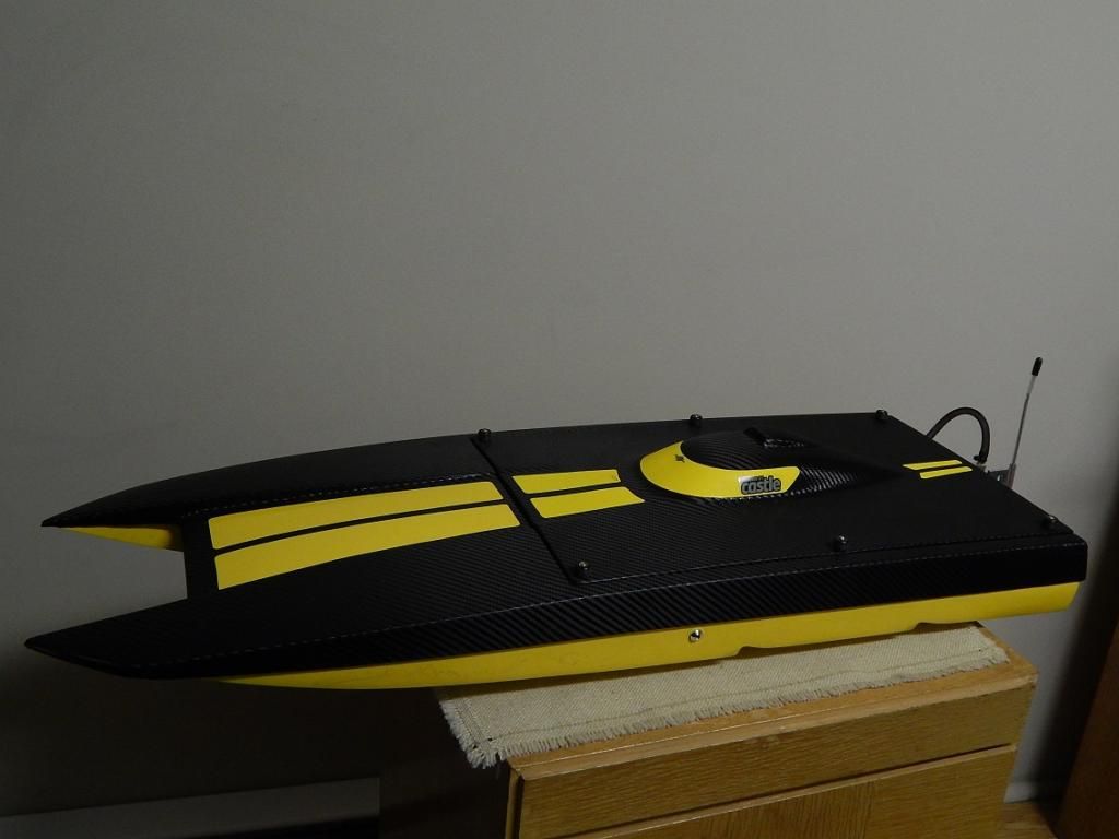

    I had to brighten it up as it was very hard to see with the wrap so I got out the exacto knife and started cutting hoping not to cut too deep

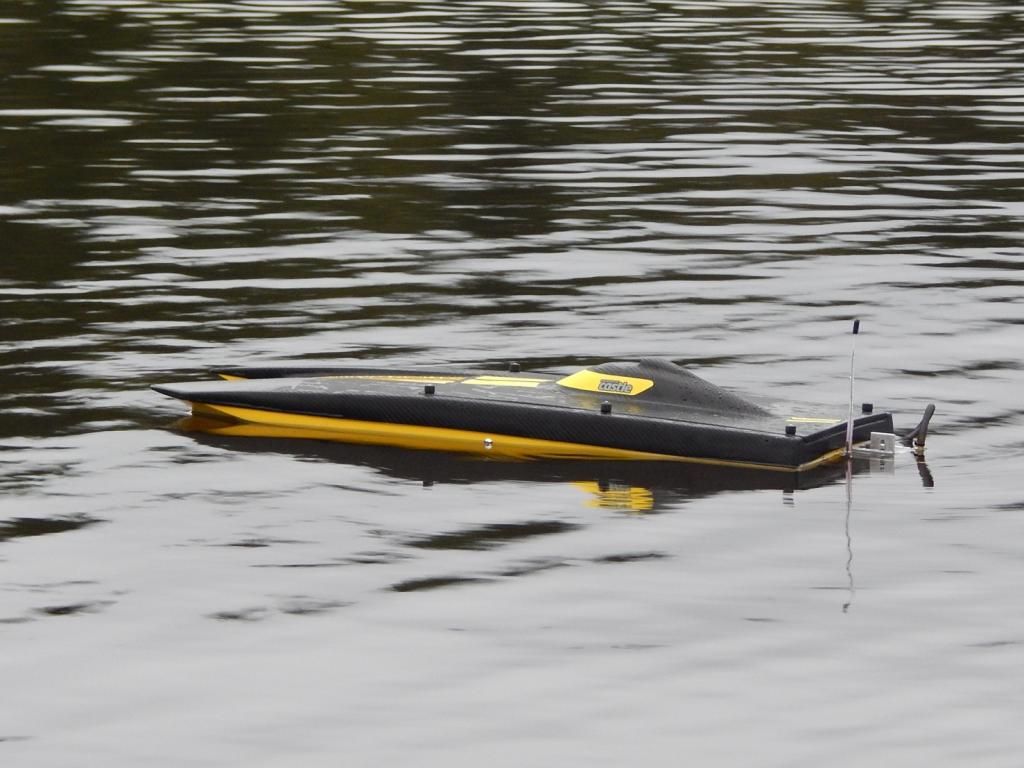

      Well installed the cc1515 @ 15deg timing today, ran the detongued x440 and ran a slower 43mph, detongued x642 @ 40mph , I have no clue whats going on ? Bad esc? Maybe not getting full throttle ? Strut 3/16 off table, this thing should be scooting? I've had enough for this year, I had to drive quite a ways to find calm water that wasn't froze, it was the warmest its been today at 45 degF. Looks fast when its going though, tried to take a vid but the batts went dead in the camera.... Not my day.. Any thoughts greatly appreciated.
      Thanks guys.

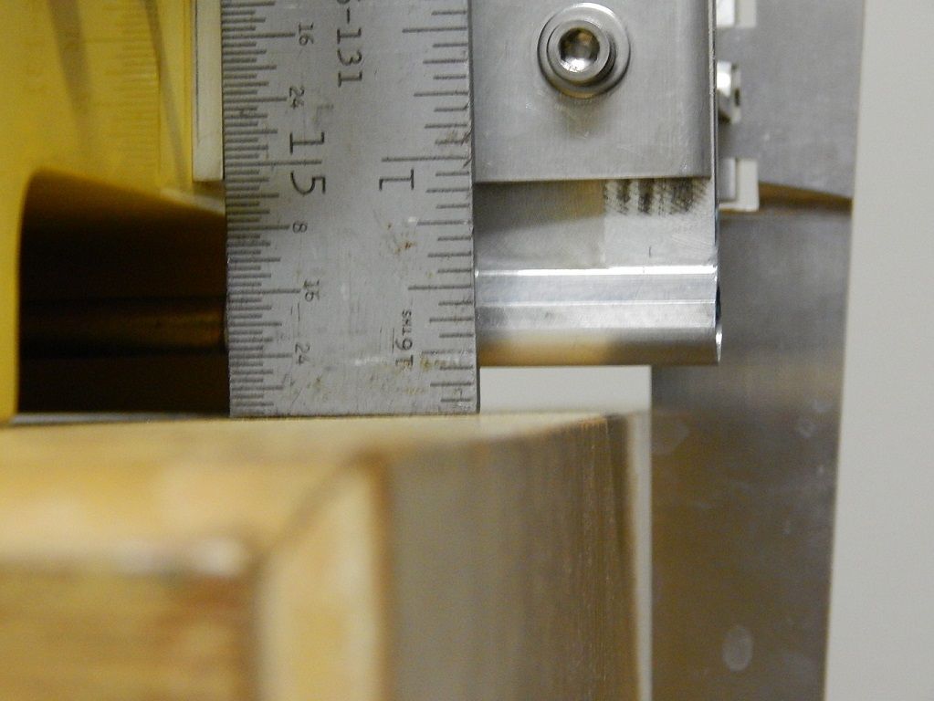

        Gimme the rundown of everything you got goin on. All your equipment and post pics of your strut with the boat on a table.

          Here's a strut pic, thanks for your help Luck greatly appreciated.
            • 7673
            I would think with a 40 or 42 mm prop I would try the strut flat on the table. I even run my 645 like that on my Geico for speed. It runs loose as heck but the 642 is good, Solid and straight.

              Hmm looks like you got the strut rite and everything sounds rite. I wonder what the heck is going on?

                Well he set it up based on my mean machine which ran mid 50's on 440 and 60 on 642.
                His strut it rite where mine is at....
                I gained speed raising it up that high

                      Just wanted to say the wrap came out very nice, looks good inside too.
                        #26
                        Looks good! I like what you did with the wrap

                          Thanks for the complements on the wrap too.
