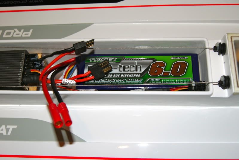

                      Hey guys newbie here just got the Stiletto ..She is straight outta the box.....I was wondering how i hook up only 1 battery...I have 2 Brand new just got them last week.....
                      Turnigy Nano-Tech 6000mAh 4 cell 14.8 volt 25c-50c
                      and i want to run it in this boat ...but we have 2 battery connectors and no instructions on how to hook up just one...Any help would be appreciated...
                      Also i watch a youtube video of the boat with a Grim Racer 40x52/3 prop ....can i just order this and use it ...or do i have to do something to it?

                        The easiest way is to solder up a reverse Y harness. But I don't recommend that. Deans connectors are right on the borderline of not being able to handle the current that this model draws. The best way is to remove the pair of deans and install bullet connectors. Such as the Castle Creations 6.5mm ones. Then it's also easy to use two 2s packs in the future or your single 4S pack with out using any inefficient Y harnesses.
                        I don't recommend upping the prop size. The motor is already working hard on the current prop. The outdrive height and pitch affect the ride quite a bit, so get the feel for it and let us know how it goes.

                          Thanx for that but being TOTALLY NEW ..i dont think i understand the lingo hahaha......you said no Y harness and NO Deans ..this didnt come with deans
                          this is what i have ...also the wire to the ESC is only 14 ga and the battery is 10ga.....I dont see how that is at the upper current level for a deans....We use Deans in 1/8 E Buggy with a 1900kv motor and the same battery with deans and never a problem...NOT arguing just trying to be sure my friend...Also they would have given bigger than 14ga i would think if the current was really that crazy no?........and REALLY on the prop?...from all the threads i have read it seems to be what people change the most also this battery comes with 4mm bullets with 10ga wire..so i think the 6.5 may be excessive What i thought was just take the red from one side and the black from the other connector and make 1...I have Deans but no Bullets like on the battery but they can be ordered if that s the best way to go

                            That's interesting. Mine came with connectors that are different than your black ones, those are called Traxxas High Current Connectors.
                            Well, even though I like castle bullet connectors, you are probably best off choosing to go with the Traxxas connectors because they're already soldered on your ESC or the red one because it's already on the battery. Those are 4mm bullets.
                            If you go Traxxas, the gold blades are very firmly inserted but can be pushed out. Hold the case with pliers, push the gold blade back through the wire hole. I've used a straight edge screw driver, but be careful not to stab yourself. Only do the wire that's not connected to the esc. Now grab the other connector and push both wires out. Take the other wire attached to the ESC and insert that blade in the housing so you're down to a single connector. Cut the connector off your battery, solder on a traxxas. Check voltage polarity before soldering and again before connecting.
                            If you go with the 4mm bullets, I don't know where to get those red connectors.
                            The prop: long story, but yeah, everybody wants to go faster. I looked at the draw for this class motor and she's givin it all she's got. If I was gonna go faster I would change the motor.

                              Cool thanx for that! ...So in essence i am going to eliminate the red wire that connects the 2 connectors together and make 1 connection from the 2 wires(red/black) from the esc...Correct?

                                I have NEVER seen a Stiletto that came with those Traxxas connectors... That's a new one...
                                To run a single pack is very simple... One side of the ESC wiring harness should have either two red, or two black wires going to it. Just make a jumper to tie these together on one side of the harness, and then plug in on the other side.
                                OR, if you want to solder on new contacts, just cut the red wire, and the black wire, near the existing contacts, and solder on a single set to the black and red wires.
                                As for Props... Jury is still out for me as to what is the "right" prop, but the Grim prop I tested in that video had a little bit of work done to it. Sharpened, balanced, back-cut, detounged, etc... There are lots of other prop options that will also work. An Octura X440/3 works well too.
