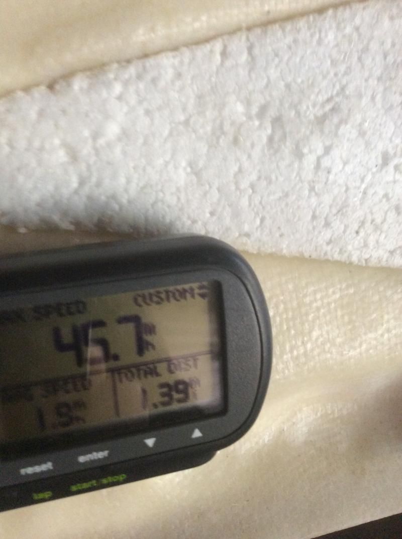

            Stock v3 on 6s and cnc 442 ran 45.7mph
            What's the total pitch of the 42x66?
