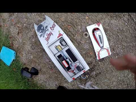

        I had to give the Motley Crew a little love today...I ran 47.5mph today with the 1800kv stock motor and x642 prop so I wanted to update my post from a few weeks ago that had prop speeds for anyone who cares...lol
        Done a few test with different props and the replacement 1800kv motor if anyone is curious on the speed differences between them on my set up. No strut adjustments were made only prop swaps and the test were all done on the same exact day and water conditions (average with some mild chop). The boat still has more in it but I wanted to find out which prop I liked best and be faster for me then I will fine tune the boat for maximum speed without blowing over.
        Batteries 2x Zippy 2s 5000mah 45c
        42x55 Grim 43.6mph (sharpened and balanced by me). This prop would probably get 44.5mph with the nano tech 6.6 batteries since they traditionally pull another mph than my others
        Prather 220 s&b 39.3mph This run was on the packs that I had already ran 3 laps on with the 42x55 prop, so maybe add 2mph more if they were fresh charged batteries. This prop got out of the hole very well with very little cavitation if any at all.
        x642 s&b (Dasboata) 45.2mph
        Batteries 2x Turnigy nano-tech A-SPEC 6600mah 2S 65~130C (these batteries always log one mph more than any batteries I use in this boat)
        x442 s&b 43.1 mph
        x642 s&b (Dasboata) 46.1mph
        Battery 1-4s Revo 435 blend 5800mah
        x642 s&b (Dasboata) 47.5mph
