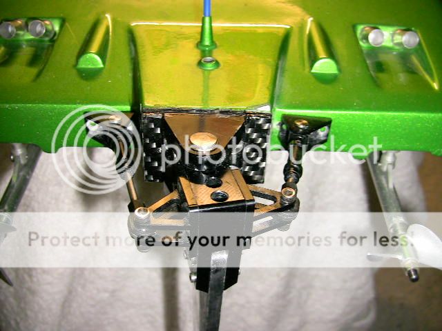

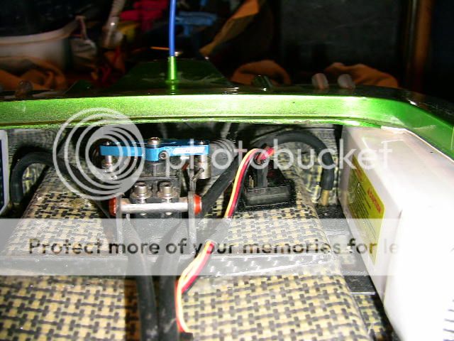

        ask for a tracking number. you should have asked when you placed the order. It's on the way to you by now. if not and you get your money back try http://kintecracing.com/Zonda_Cat.html I just ordered props and got a shipped reply right a way. The rudder that comes with this boat cracked my hull at the base. find a better one that uses a 4 bolt plate. I went with the 150mm push pull rudder that sells for 55.00 http://kintecracing.com/Hardware.html you will need to change the servo mount to make it work. I also added 2mm carbon plate to the rear mount to repair the damage that the rudder mount had made. I would do this regardless. You may not have to change the rudder if you added the plate to strengthen hull. I used marine epoxy that you can get at the hardware store.

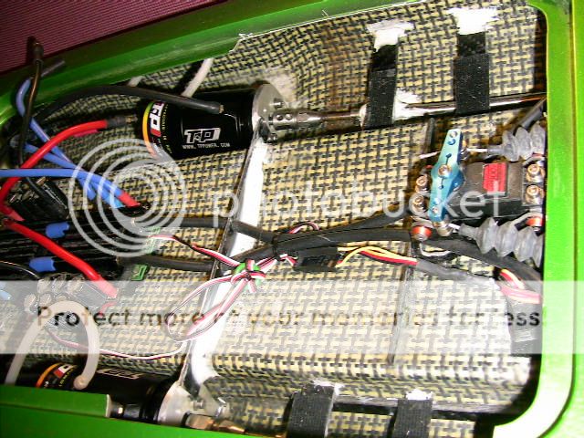

                        The motor and one of the right props came in. I sent a picture that you see here of the wrong prop being sent. I hope Kintec racing is on top of it soon. the motors look great. I put the stock sss3674 motor next to it. The water jacket holes are small I will see if this needs to be changed before replacing them.
