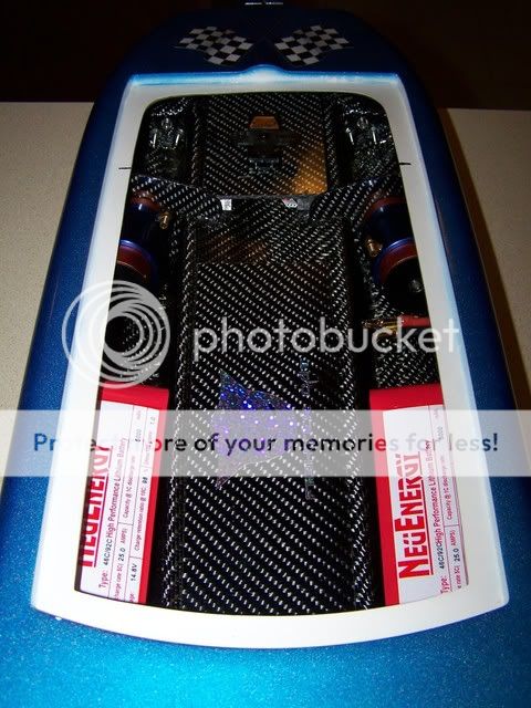

      Just thought I'd post this here. This is a boat I just did a couple days ago. This was done with just carbon fiber fabric and epoxy resin, which was applied to the hull before and after the fabric was laid. This is probably a more difficult way to get a clean look if you're a beginner, but it ensures a complete bond with the hull through resin, not spray adhesive:

          That turned out really good kieth! Nice work.
                        Nice job ! Link to where you got the fabric ?

                            Thanks Tony!
                            I actually don't have a link to where that fabric was purchased, because that fabric was sent to me by the customer. The fabric was nothing special though, just 3k plain weave (2x2 twill will have the diaganal pattern where plain weave has the checkerboard look). I actually questioned using the fabric that's in that boat because it was folded when it was shipped, and the weave was badly distorted. I found the best spot of fabric I could and tried to fix the weave, then cut it so the imperfections were in spots that weren't as noticable. Wherever he got it from, I personally wouldn't reccomend them. Folding carbon fiber is a big no-no.
                            There are lots of places to get it though, probably some right in Cali that will save you shipping if you search "carbon fiber fabric". If you like the looks of the fiber in that boat, get the plain weave. The 2x2 twill is what you see on aftermarket car parts and looks like this:
