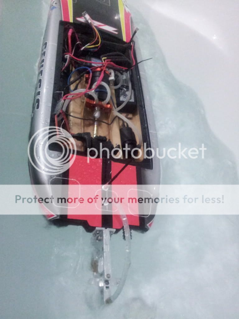

                          One of the last runs with my boat before I started stripping it down
                          Will see if i can find better pics later. But the pump can be found on eBay. And turnigy receiver switch from hobbyking

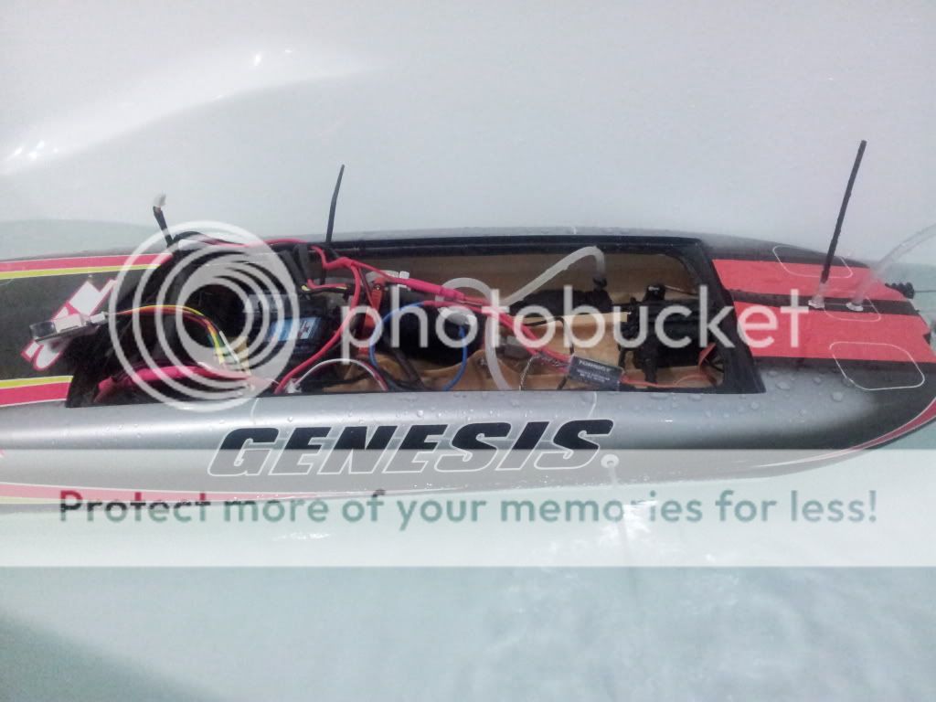

                              That looks like a windscreen washer motor... I have a few of those laying around..... mmmmmmm, I didnt think they pulled water well at all, I will have to do some testing.
                              That thing fly's on 6s with the turnigy motor man, looks somewhat unstable! Did you get a read on the speed it was pulling, its definitely moving!?
                              I broke the sacrificial nylon screw when I ran over a patch of lillys down at the river this morning D'oh but Ive fixed that already. Im carefully estimating the speed of mine at 70kmh, will get a hot wheels radar gun soon and see what its actually doing.
                              I will make the planned mods I have to run separate circuits 1 through motor & mount, and the other for the ESC, with 2 outlets. Hopefully the rudder picks up enough to feed both circuits sufficiently, will know soon enough.
                              Some pics of that boat as it sits now. (if they work)
