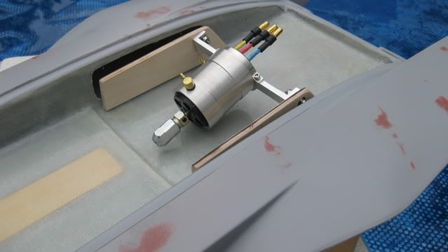

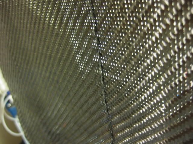

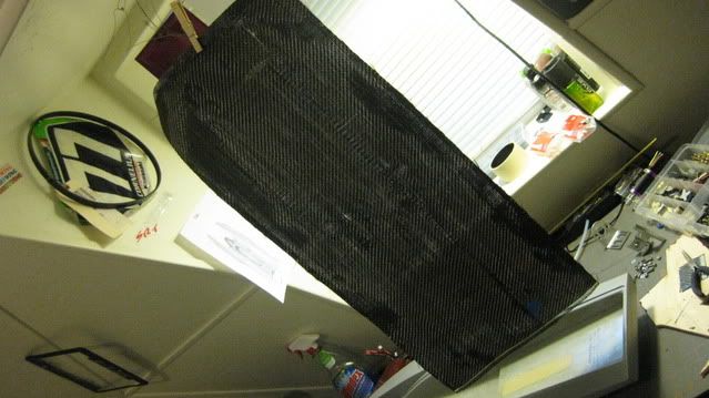

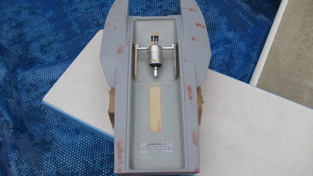

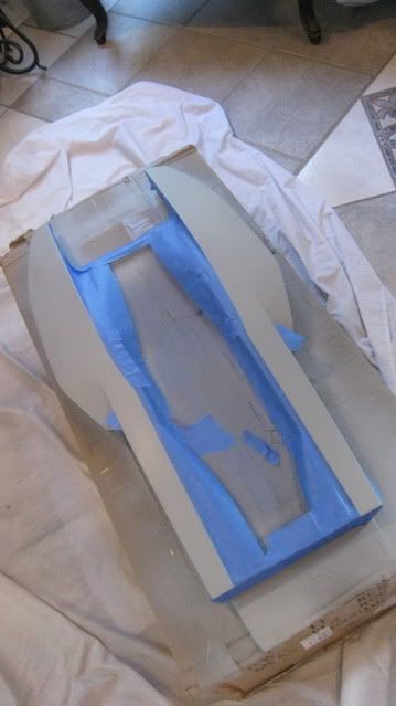

    Im about to start laying down the CF Twill, but first I wanted to get a shot of
    the inside one last time before It goes in.
    This stuff is very annoying, twill will fall all to pieces if its not taped, or
    glued were it needs to be cut..I used Medium CA glue and run a bead down
    each sides, then were it need to be cut...
    after that hang it up so it will dry...

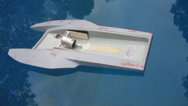

    Im also trying to figure out how this motor is gunna fit..the mounts are alittle to tall
    an won't allow the cowl to sit flush on the hull..
    I order the William's Racing mount and its not going to work because of the water jacket.. and Im deffinatly using water cooling for 5s...
    Ill figure somthing out im sure..

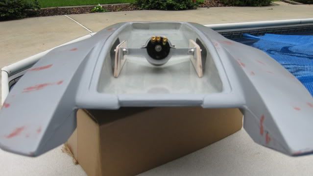

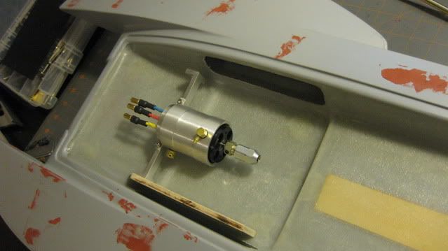

      Motor mount almost finished, Im waiting for the Speedmaster rudder and
      some other parts to come in, Ill try and get the drive shaft mounted in tonight
      and maybe try to get another coat of primer on before my base coats come in tomorrow
      afternoon.
      Here's more pictures..

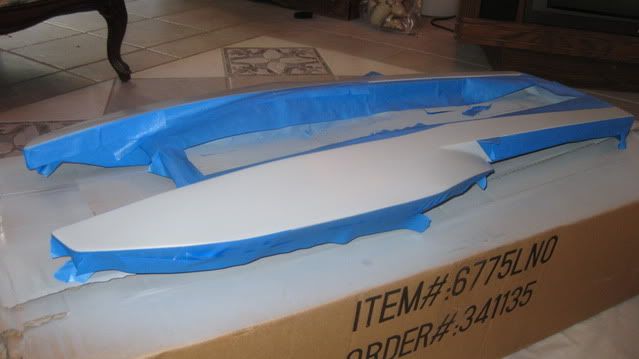

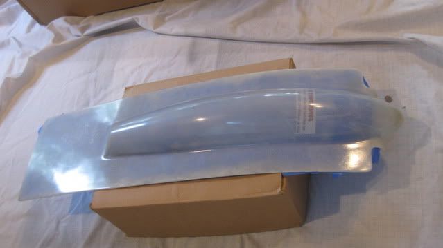

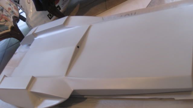

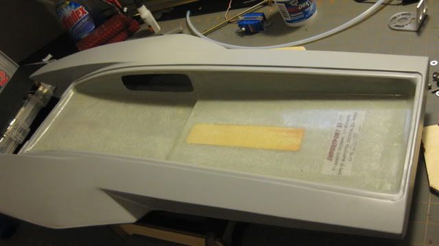

                  Cowl next....
                  Last coat of primer on the hull.
                  LMT
                  LehnerMotorenTechnik.com

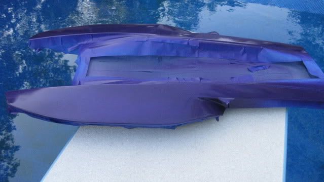

                          #57
                          Ready for a coat of paint yay!!lol
                          LMT

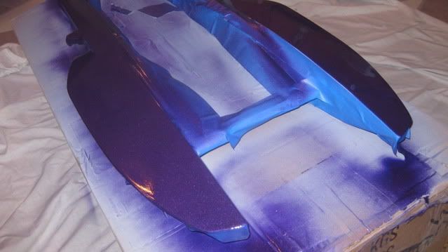

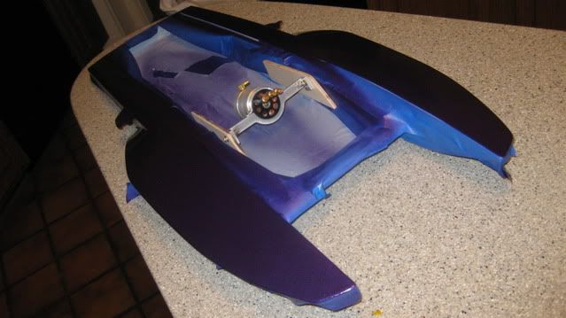

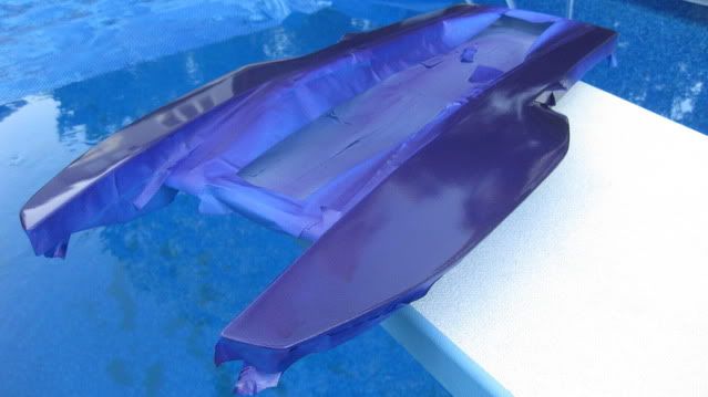

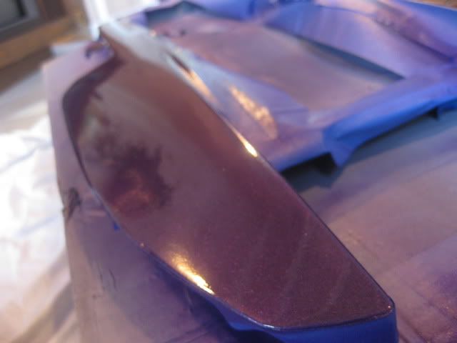

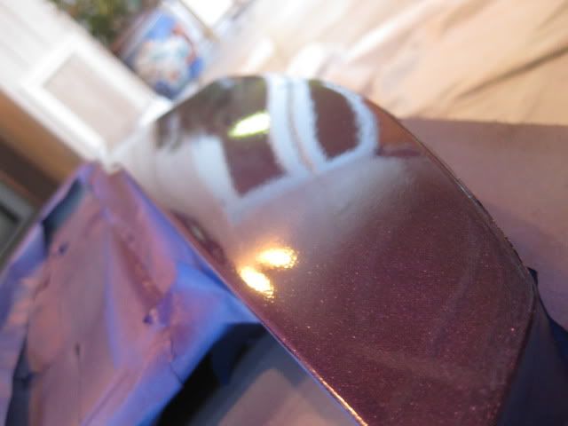

                          • nate
                            • 1652
                            #58

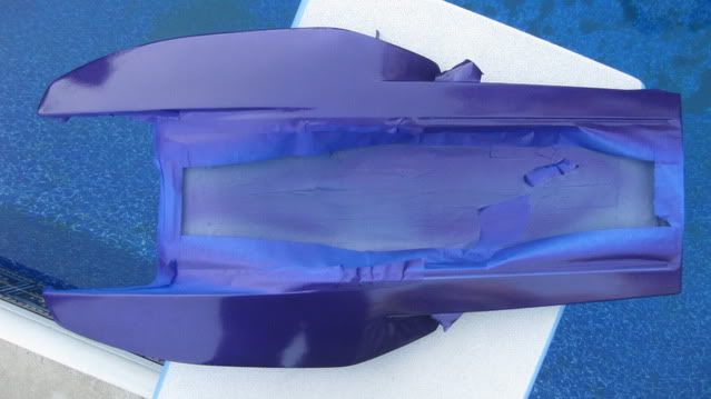

                            Purple haze. It went on great, there are minnor places that need sanding and a light scruff before the Clear coat goes on, by the way this is only 1 of 3 diffrent purples going on the hull.
                            LMT

                                These picture's in no way show this paint justice, There is no way to get
                                an actual shot outside or in to show your what the true color is, maybe my camera...
                                Inside diffrence, its almost black, All I can say is SICK LOL
