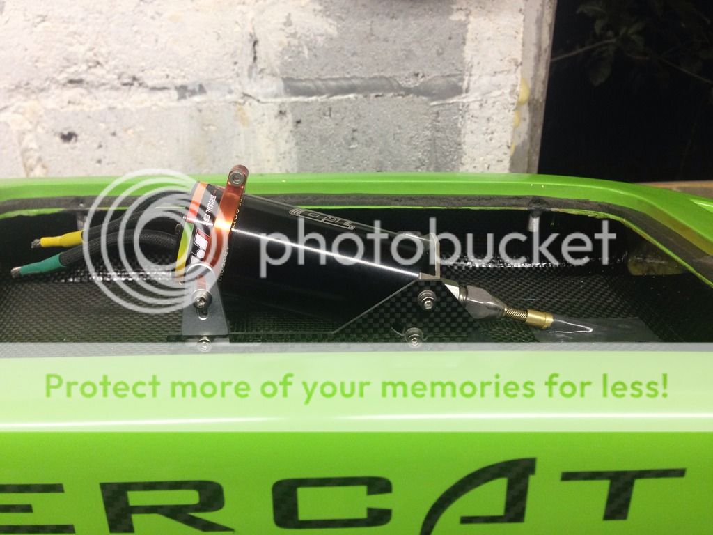

              My rivercat tube is about that same length you need it like this
              • Newboater
                • Jul 2016
                • 359
                Thanks,
                Can you show me a picture of the inside by the motor also..
                • Mxkid261
                  • Jun 2015
                  • 734
                  Sure thing. Motor is as low as it could go with a long cooling jacket.

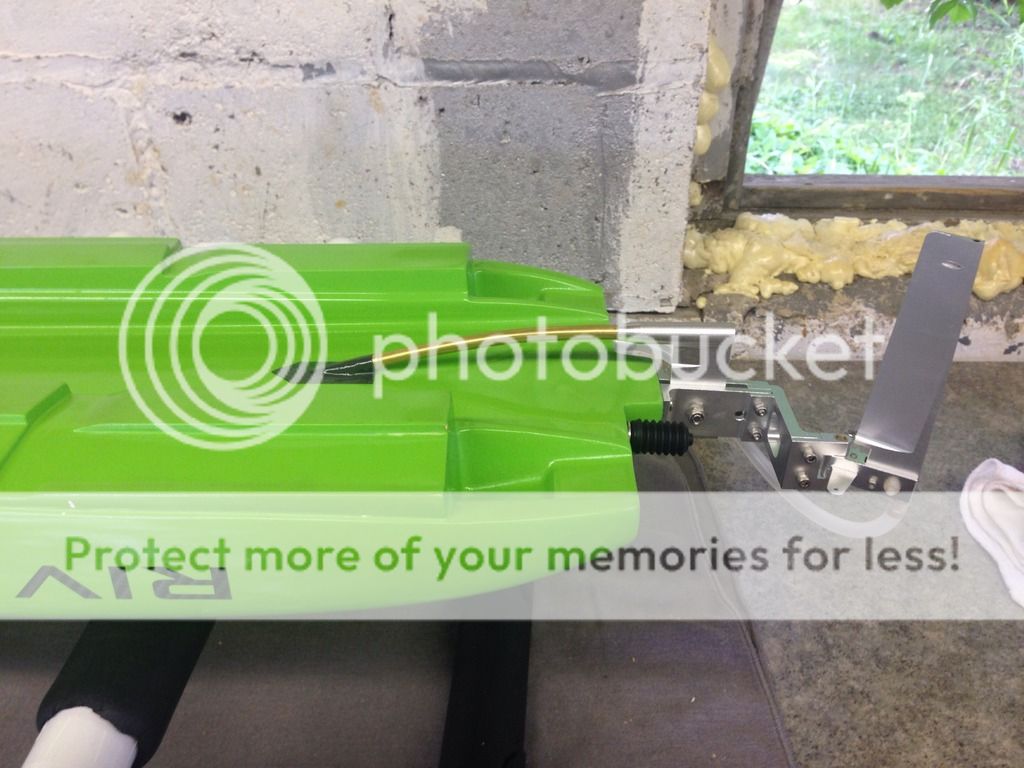

                      Stuffing tube
                      Okay redid the stuffing tube does this one look good before I JB weld it in??
                      • fweasel
                        master of some
                        • Jul 2016
                        • 4285
                        The bend radius is much improved, but the tube/strut looks really low in relation to the bottom of the sponsons. Can you post a picture or take a measurement of the bottom of the strut in relation to the bottom of the sponsons?
                          Here is a picture with a 1914 prop. The strut is as positive as it can go to accommodate this prop a small prop I can go more positive. Is it okay for the stuffing tube to be above the sponsons.
                          • fweasel
                            master of some
                            • Jul 2016
                            • 4285
                            I have no experience with that hull, but on my 29" cats, the strut sweet spot was a good 3-4mm above the bottom of the sponsons, at a neutral trim angle. I could place the boat on a flat table without a prop, and the strut and stuffing tube would not touch.
                            Vac-U-Tug Jr (13mph)
                            • TheShaddix
                              • Sep 2013
                              • 759
                              As a general rule you want the strut always inline with your sponsons, not below or above. This way it won't be creating any drag. Only your prop and the bottom of the strut should touch the water. When you set the boat on a flat table you should have all of the 3 parts touching down evenly. If you find that your prop is too small, put a bigger prop on. Only half of your prop needs to be in the water when it's on plane.
