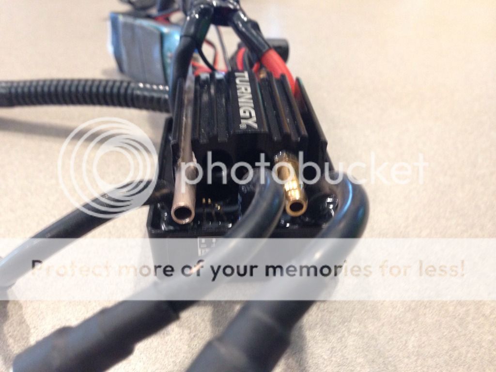

                  I smoked a v3 seaking 180 last summer with very little 6s time on it the capacitors would get quite hot after a 10 minute run, as would the esc itself. 20 minutes seems pretty long for anything FE. Im assuming you weren't running an external BEC on the v3 esc? I ended up getting the Turnigy branded v3 180 from HK, which comes with an extra 4 bank set of capacitors and I was advised by others to run an external bec, and using 8mm bullets. I also added an extra cooling line to the fins. It Barely gets warm now, runs extremely cooler than the seaking ever did.

                    Op, if you get another t180 try adding a brass tube pressed down into the heat sink find on the other side of the esc. There's a couple threads on it. Very easy to do.

                      My esc temps dropped considerably when I added the brass tubing to the heat sink. Why would they not put 2 lines on the heat sink from factory? Seems like a no brainer lol

                              I simply ran a 3/16 drill bit through the fins on the one side and slid a piece of 3/16 copper brake line through, worked like a charm
