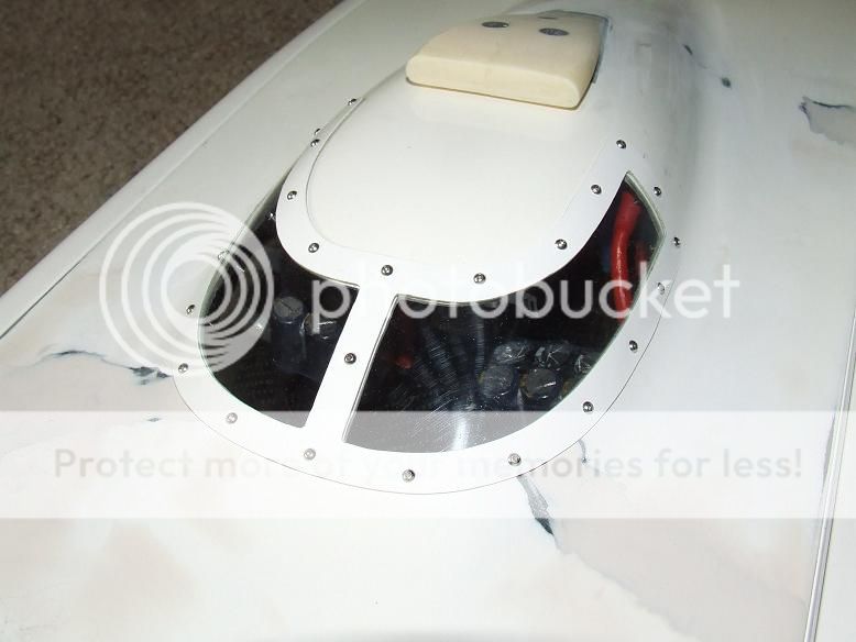

                            by the way the picture of the fixed HPR cowl is from me. It was a cowl from my HPR06 Repsol, which was HPR quality but still just GFK as I wanted to use GPS inside. Stuffed it just around 80mph and the cowl completely broke into seperate parts.
                            I fixed the hatch for another build but just for display purpose with the cockpit glasses and window frame, the boat got a paint job anyway. And for running there is another one.
                            And on my HPR the cowl was replaced with a full-cevlar version with honeycomb sandwhich core. Now its about 1/4" thick, that did the job so far.
                            BTW: Still waiting on pictures of that Daytona!
