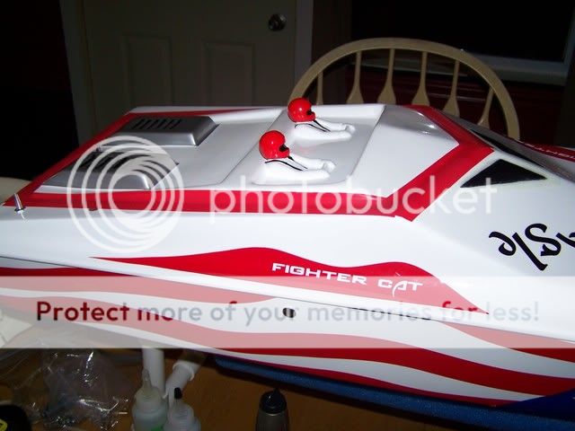

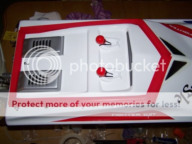

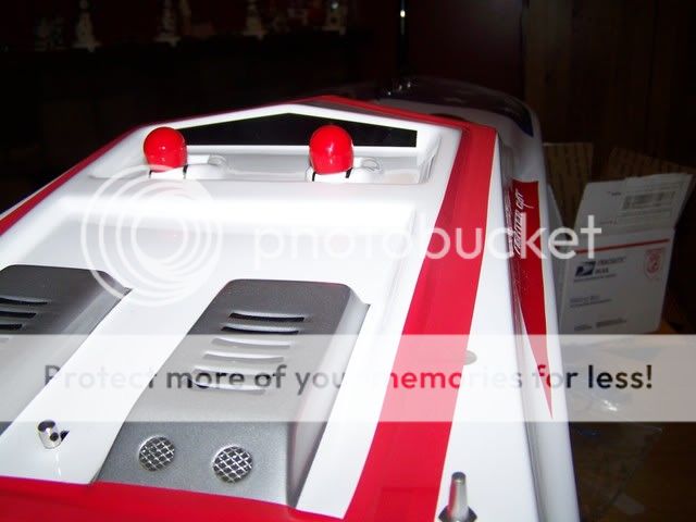

                  Got a few not-so-fun things done. There were a lot of holes to seal in this boat. In fron tof the windsheild they cut out some triangles as if they were carving eyes on a pumpkin and put screen behind them. There were holes in the hatch with screen as well.
                  I didnt know how I wanted to seal the front triangle holes, but my first worry was blowing out whatever I put in there if it gets stuffed into a wave at high speed. I ended up taping over the outside and putting a layer of carbon fiber over the holes and a good inch + around the edges. Then I made carbon fiber panels for the outside and epoxied them in. Finally I applied a layer of clear epoxy over the outside to seal them to the hull. I still have some tape lines there to sand, but it doesnt look to bad.
                  For the holes in the hatch, I left the screen in, taped behind them, and just filled them with thick epoxy. I also filled a kill switch hole, antenna tube, exhaust outlet, and three holes on the transom from the water pickup I removed.
                  Not much to look at, but here are a couple pics:

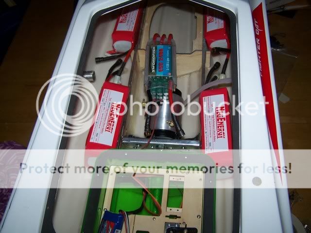

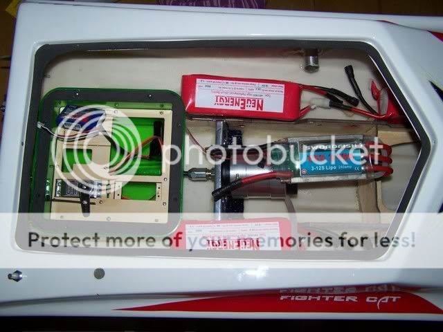

                      Got the motor mounted, and servo/steering sorted out. I got a billet aluminum cased servo from HK that seems to have lots of torque and should move the big rudder quite well.
                      I put a small strip of CF at the base of the motor mount to help hold it in place and keep it from wearing the bottom of the hull. Im not going to get too carried away with Carbon in this build, its pretty strong and doing the whole boat would add a lot of weight and cost a lot of $$. The rx battery and rx are just thrown in there for function, they will be mounted later.
                      After mocking everything up for a COG point of 30%, I now know what I want to do with the esc. It looks like I will be making a simple aluminum piece to bolt to the rails then go over top of the motor and hold the esc in place about where it is in the pictures. This will work well in consideration of motor to esc wiring, battery to esc wiring, and (least importantly) esc to rx wiring.
                      I am planning on making pads that hold the pairs of batteries for each side.

                          Anyone have any thoughts on this?....
                          I was considering a subhatch, but now that I have everything sealed up I am thinking about just taping this hatch. Its not super easy to tape down, but I think it will work. I used red tape so you could see it in the pics.
