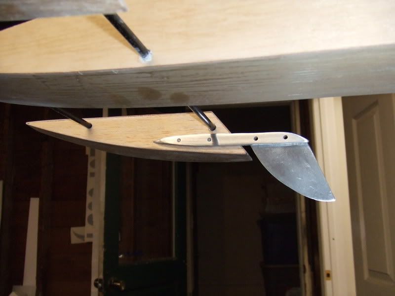

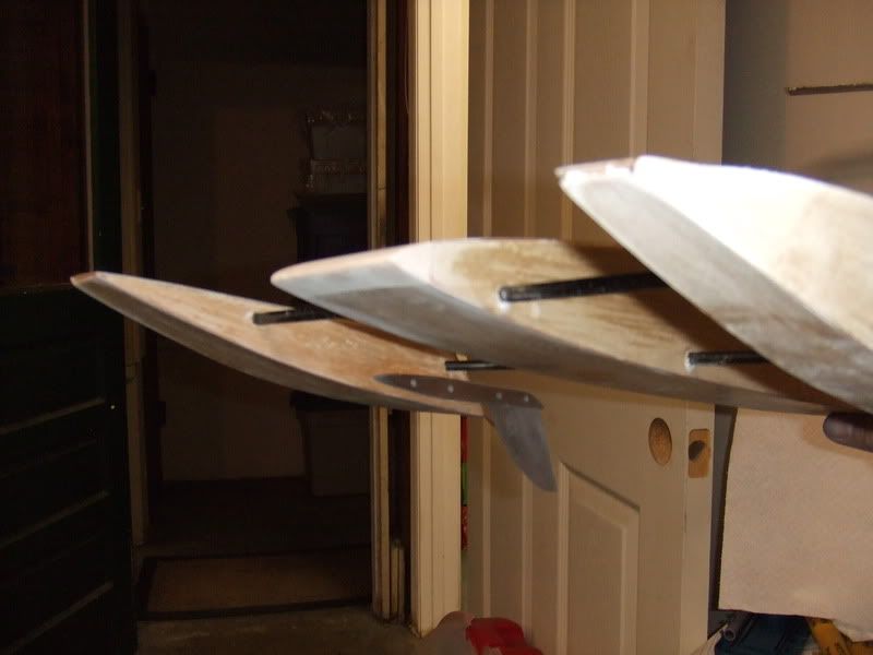

                              Well I got motivated last night & tonight to get some more work done on the rigger. I got the front sponsons foam filled and assembled. I took the rear sponsons off, got the front mocked up for mounting. Made the turn fin and spare then mocked them up on the boat. All that it left is body work, hardware and paint. I'm gong with the soliger hydro with a .150 cable (trying to keep all my boats somewhat alike hardware wise).

                                turn fin mount.
                                Nice looking turn fin bracket man, how thick is it?
                                Turn fin looks good too, alloy i presume?
