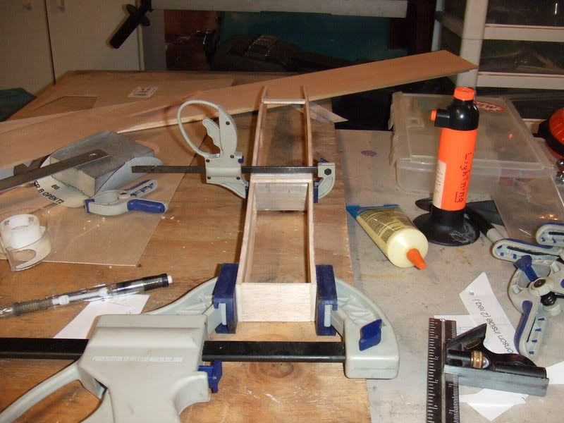

    Hey guys with the help of a bunch of internetters I got the idea and plans to build this boat. I am using 1/8 balsa and 1/32 light ply. My motor mount is made from aluminum. I will post info and pics as I progress with the build. So far I have the majority of the tub done.
    Power will start with a trinity p2k stock motor with a novak m5 esc and a 6 cell battery. After I see how that does, the stock sv27 motor and esc will go in the boat for testing.
    Running gear is still up in the air and I'm open to suggestions.

    all the wood parts were cut out with an exacto knife. After the ply was glued on the tub sides were clamped together and sanded so they are the same. front sponson insides were also snaded even. I will be using carbon fiber rod to join the sponsons to the tub.
    aluminum motor mount was cut out with assorted dremel bits and a drill.

          I was thinking about buying some clamps like that,do they work good for you
          S.S.R.C-Southern Style Radio Control
          • Avanti
            • Nov 2007
            • 1280
            Yeah they are great, I just bought two more mini bar clamps at Target today.
            The spring clamps are good for holding the two pieces together so you can sand them even. (the ones in the picture are from Lowes)
