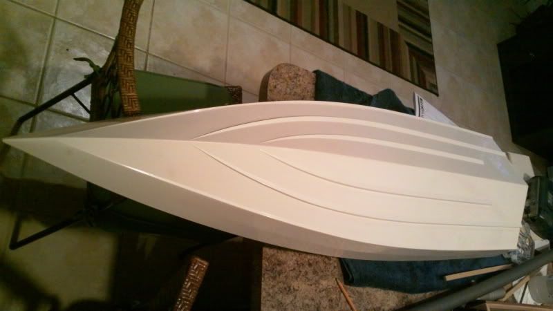

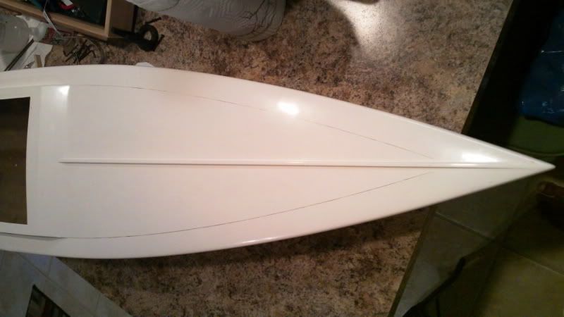

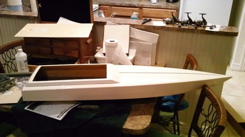

    Here are some pictures.

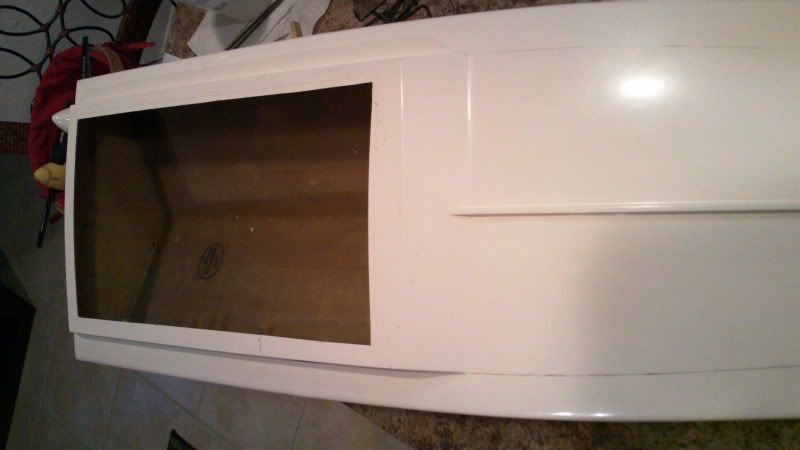

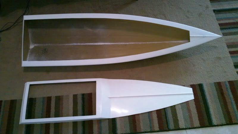

    Marking the lines for the cut.
    Made the cut. No going back now.
