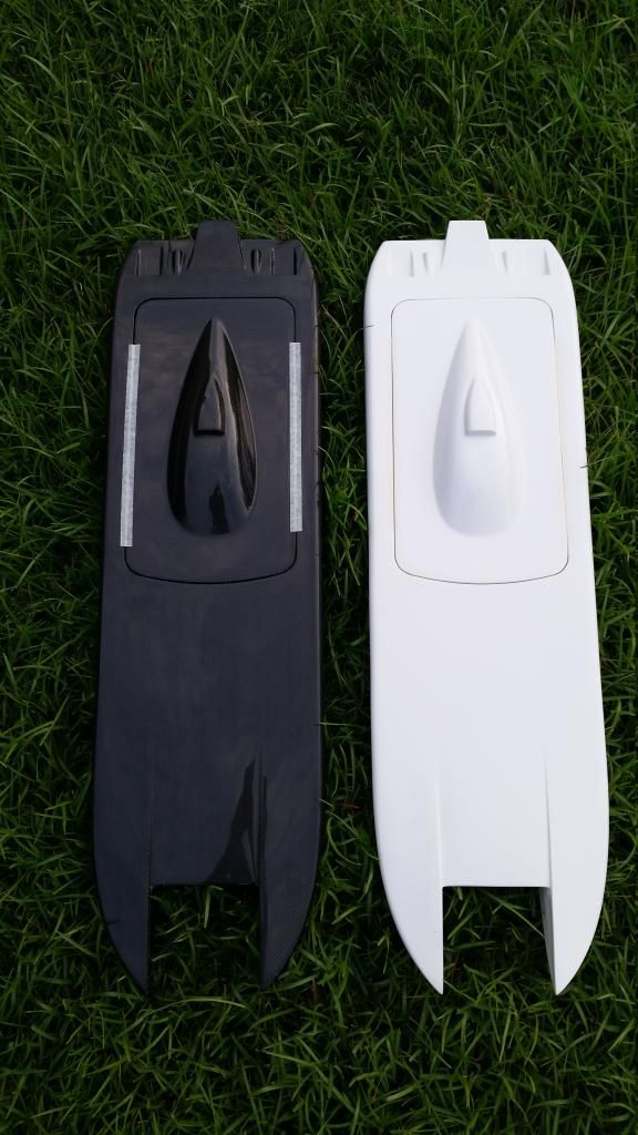

    I just got two new hulls in to build. One for me and one for a member. His is the carbon fiber one (beautiful of course!) And mine the fiberglass one. We came up with an awesome idea. The Carbon boat will take the fiberglass top and the fiberglass one will have the carbon top. Then the fiberglass boat gets painted orange and top stays carbon. The carbon boat gets an orange top. Then the orange boat gets carbon decals, carbon boat gets orange decals. Pretty much flip flop between the two and both can be gps for speed runs. Here's the twins from the onset before getting started.
    I havent decided what my combo will be on mine. I'll just get busy reinforcing it. It's much more flimsy than the carbon one. The sponson tunnel feels like paper almost. The carbon version will have a 1800ish kv motor with a new seaking 180 V3 on 6s. Offset strudder, 3/16 flex, savox waterproof servo and my aluminum hatch bolt and seal set up. They will both have two part kintec foam in the hull and some other goodies along the way that I won't mention yet.

          what length are these?

              32". Same exact boat as my 70mph rivercat. Very very nice hulls. Did I say very....
